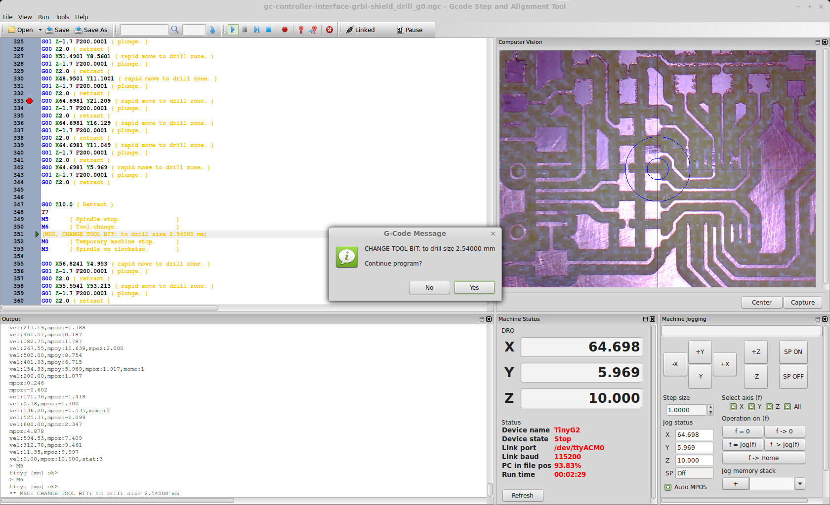

What is the main differentiator for Gsat? Is it just an alternative Gcode sender? Or are there specific use cases you are solving that other Gcode senders don’t solve? I think the webcam view is cool.
I made gsat while back, the big idea is to treat Gcode as any other code. For example if debugging C code on a PC or an embedded device one can put breakpoints analyze what is going on with the machine registers, memory, program counter (PC) and many other aspects of a machine and also to modify them at will… gsat allows one to treat Gcode and the device Grbl, TinyG, or TinyG2 in a similar manner. Being able to set breakpoints and change/align, or modify the state of the machine and or execute only parts of the code. For example execute a second time but only for the last pass for a pocket operation. Also to modify the Gcode itself.
The camera view is for alignment; with a camera properly mounted and calibrate to a known offset of the tool. With this setup one can actually target say a drill hole with the camera and then just move the known distance to the tool (have to know your machine backlash), reset the machine coordinates to those coordinates and continue with a drill program. All of these allows one to change tools or even remove the workpiece come back and verify aliment before continuing the program or move to another program.
Other features like init script after device detect useful for devices like TinyG2 (Arduino DUE) which currently requires recompile of the code to have new settings saved, with the init script, these can be setup upon connect. But you can get a fuller picture at the github readme file.
