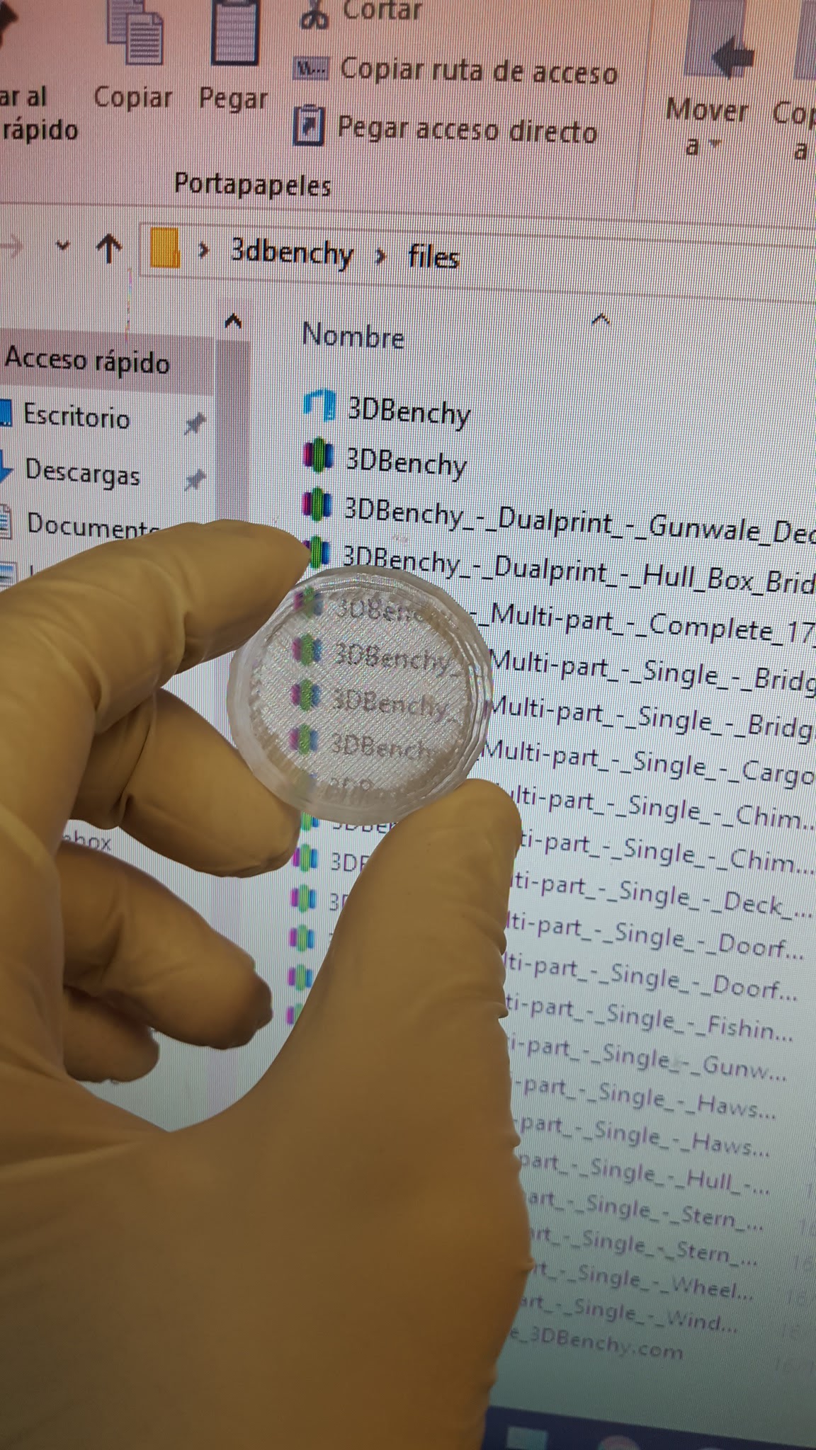

10 mm thick, Wow!!! HT Clear ColorFabb let's play...
10 mm thick, Wow!!!
HT Clear ColorFabb let’s play… :slight_smile:
You need to design a lense! Do it for humand kind!
Pretty impressive… I didn’t think the clear version of the HT filament would be that clear…
Why are you wearing a rubber glove? :slight_smile:
Mind sharing setting?
Done that before. Youll need to overextrude a lot but it will be transperent
But thats not a Benchy!
@PrintinAddiction I was painted at the time :slight_smile:
@Philipp_Tessenow Volcano 0.8 mm layer: 0.1 mm infill 100%, nozzle: 260º bed 100º
@VolksTrieb thanks for the advice xd
A fresnel lens with that filament would probably turn out great.
