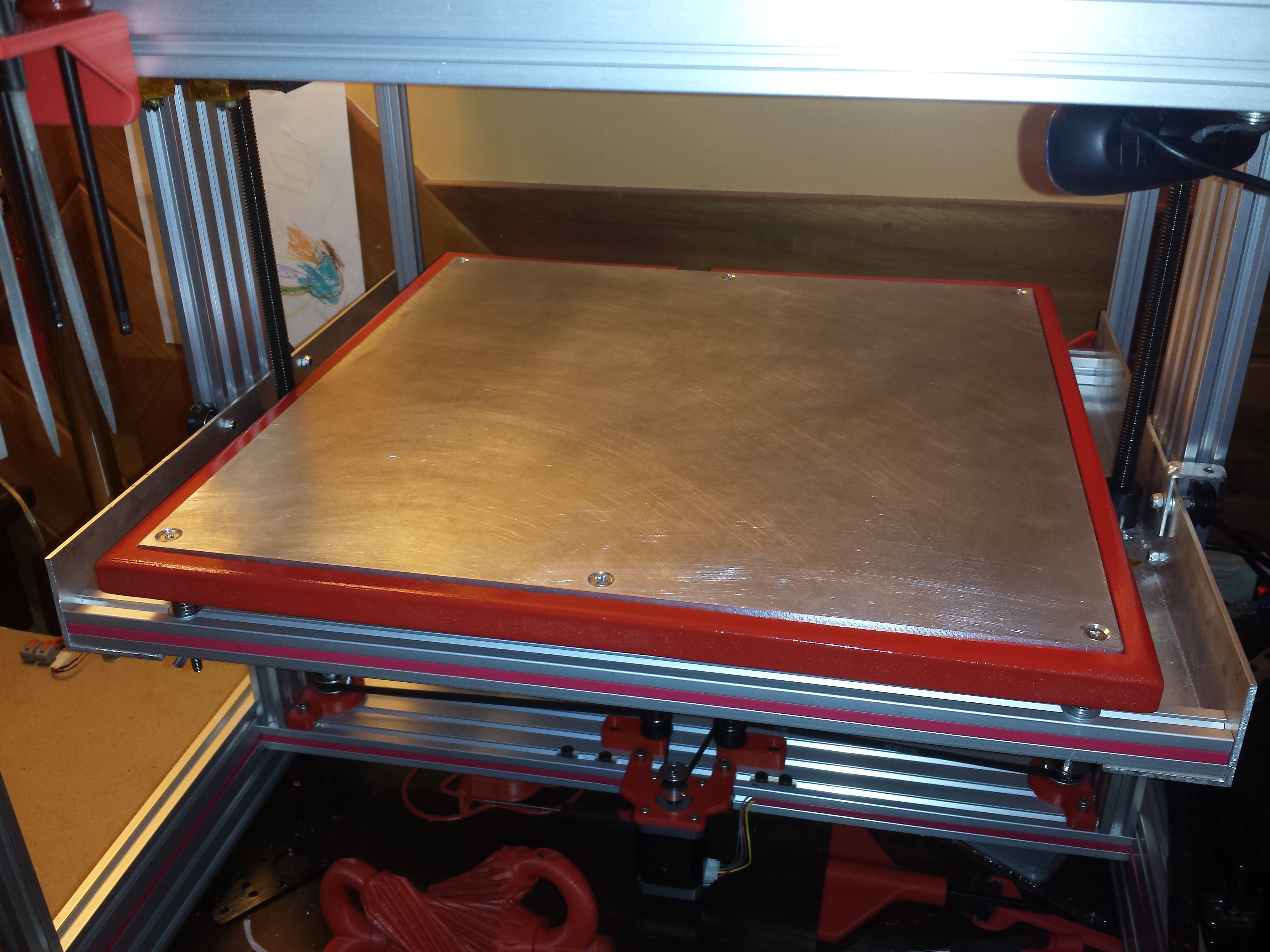

120v bed assembly installed. I will wire it up for the maiden voyage tomorrow. I have found my wiring skills drop exponentially after midnight. Or I should say my fire starting skills go up.

I’d be afraid that the MDF base would warp from the heat.

@Jean-Francois_Coutur I will have glass on top. The real weight is the 1/4" aluminum. The MDF has very little weight (it is almost entirely hollow from being routed out to countersink the bed and heat pad.
I have a high torque 60mm long nema 17 driving the bed. There has never been an issue yet. The gear reduction from the pullies and lead screws make simple work of that.
@Thomas_Sanladerer the MDF is only an insulator. Bed leveling is completely divorced from the MDF so I hope even if it tried to warp there would be no net consequence other than an air gap. The MDF is sealed with 500F exhaust manifold enamel, then several layers of Kapton tape. I hope that helps. Time will tell.
Up till now I insulated the old bed with 3 layers of 1/4" cork followed by 1/4" fiber hardboard. It has performed well for almost 1 year.

New heated bed with SSR works great. 110C in about 3.5 minutes (not bad with a 1/4" thick chunk of aluminum for a heat spreader).
Based on thermocouple testing via my multimeter and also via my IR thermometer it takes about another 2-3 minutes before the glass top equalizes to the same temp. But all in all I couldn’t be happier. Temperature is rock stable after some PID tuning.
Now it is time to cleanup the wiring (and to be honest also cleanup the office from all the tear down work recently).
One note is I had to drop the “Max Bed Power” in marlin from 255 to 220 to avoid overshoot and PID overtemp failure. So (800W/255) x 220 = 690W. I think that means a 700W bed would have likely been the sweet spot.

@Jean-Francois_Coutur I have a 12hr print going since last night. It is working perfectly so far. The 1/4" heat spreader is far better at maintaining flatness across the bed. My 1/8" one had far more of a bowing issue at the corners by the mounting bolts/springs.

looking at the picture, how did you make the glass stick on the bed ?
@Jean-Francois_Coutur right now its just painters taped down which works fine. But long term I will design spring loaded clips that swing out of the way at the corners.
If it was me, I wouldn’t even stick it down - the forces on the bed are entirely vertical. Where’s it going to go?
@Mike_Thornbury nozzle catches could slide the plate.
And so a well-fitted plate would overcome those. Warm ABS vs hardwood? I like the idea of a plate that I can take out - put all the connectors on a plug. Makes it easy to clean, easy to maintain. I have a 230mm x 300mm 6mm aluminium plate as my spreader - it weighs about a kilo. Add in the heater and glass and it would take a heck of a nozzle catch to knock it out of its bed. I have a CNC router, I will be making a custom-fitted hardwood platform.
