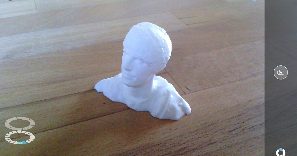

Some days ago I stumbled over the Android App in the Play Store. That’s why I had to do some testing (my last #scan was taken almost 3 years ago).
But I had no luck. The camera resolution of my ASUS Transformer TF101 was probably too weak, so the first attempt was useless. Similar result with my smartphone Samsung S3: useless! I finally did it with a regular camera (Nikon 1 J2).
The result is very good - especially the skin.
More about the process in German:
I took 41 pictures with 3872 x 2592 resolution. But some of them (5 or 6) were automatically removed by 123D Catch.
