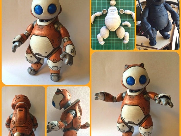

I have so much in common. I’m printing a mini candy machine :http://www.thingiverse.com/thing:938799 . There’s a lot of surface area and I’m using a little bit of hair spray on the bed of my Simple Metal. My time lapse took several minutes to render on my Pi. Where’d you get the exhumer?
Found it!
Awesome man! I’d love to see the results! I got the exhumer from Home Depot where the pry bars are :slight_smile:
I think I’m going to take something like this on next.
Sure I’ll post the results here when it’s done. Might be 2 days though I think I need to wait for more clear PLA to ship.
