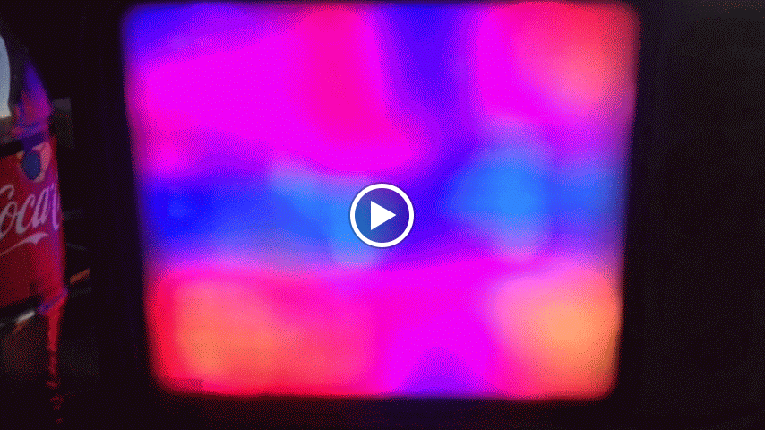

* 16x16 matrix off arduino nano@16mhz * Using 4 octaves of 16x16 noise for
  • 16x16 matrix off arduino nano@16mhz
  • Using 4 octaves of 16x16 noise for brightness
  • Using 1 octave of 8x8 noise, with a lower speed value, for hue
  • still pulling 20fps
To put another way, I’m computing nearly 22k points of simplex noise per second…
The due runs this at 62fps. There’s a pretty hard cap of 130fps, if i’m spending 100% of my time pushing led data (I know i know, if I’d get the parallel output code tuned up and out the door…)
