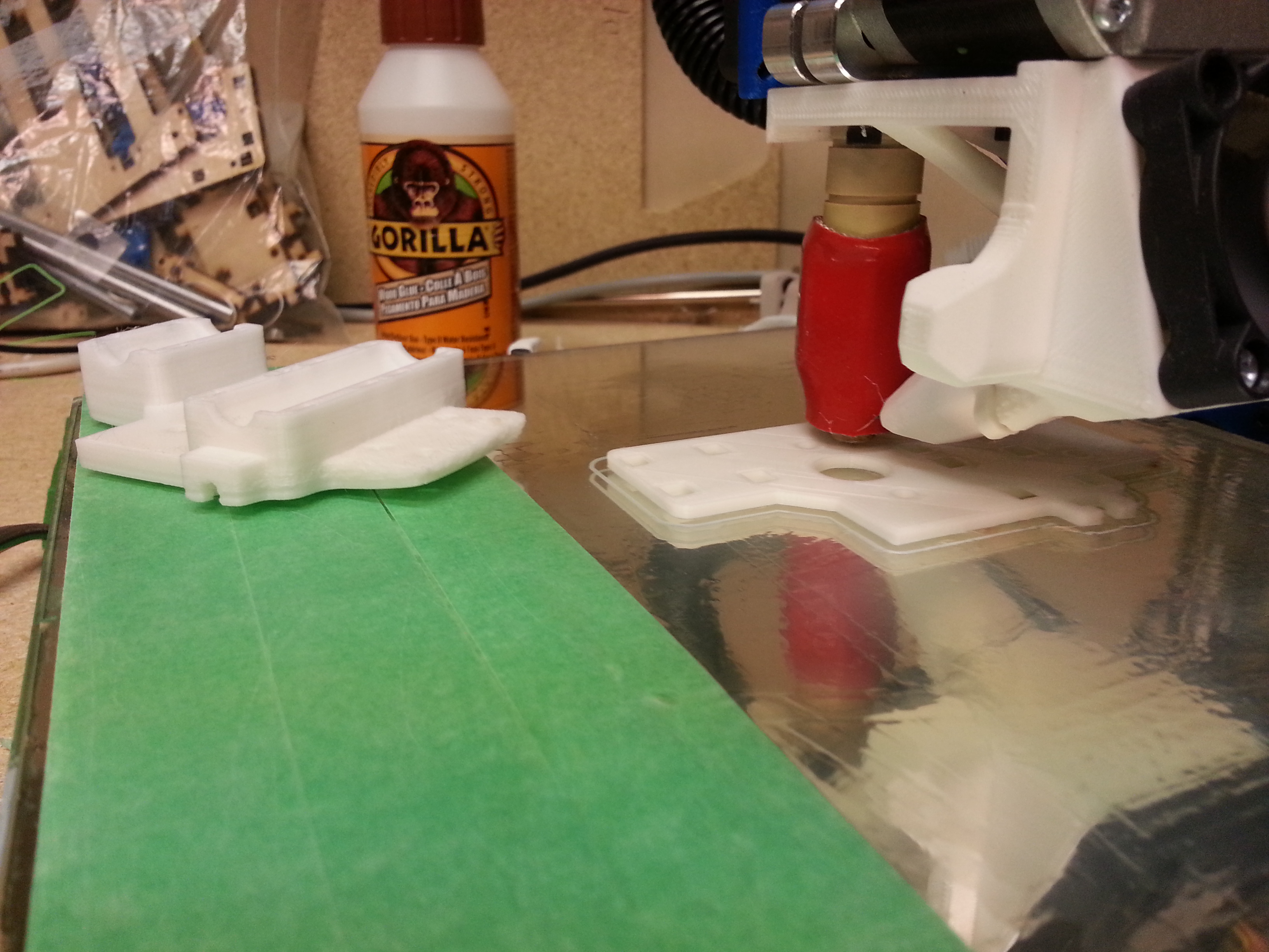

1st attempt at a critical piece pulled the tape off the glass.
1st attempt at a critical piece pulled the tape off the glass. In desperation, I’m trying gorilla glue. Spread a modest layer with a blade and quick dried with a heat gun. Started print while (unheated) bed was still warm. No shrinking/curling so far.
Question is: What are the chances I’ll get this off tomorrow morning when it’s finished???

pla. unheated custom bed (broken mirror) on a modified @Printrbot Simple.

I’m having no problems with the print sticking to the tape - it’s keeping the tape on the glass that I’m struggling with.

Let us know how it goes. I think gorilla glue is way to much for this “removable” application. I use a glue stick and sometimes have problems getting large prints off the bed. Buildtak may work well for you. I don’t have auto bed leveling and my hot end made contact, melting it a little.
