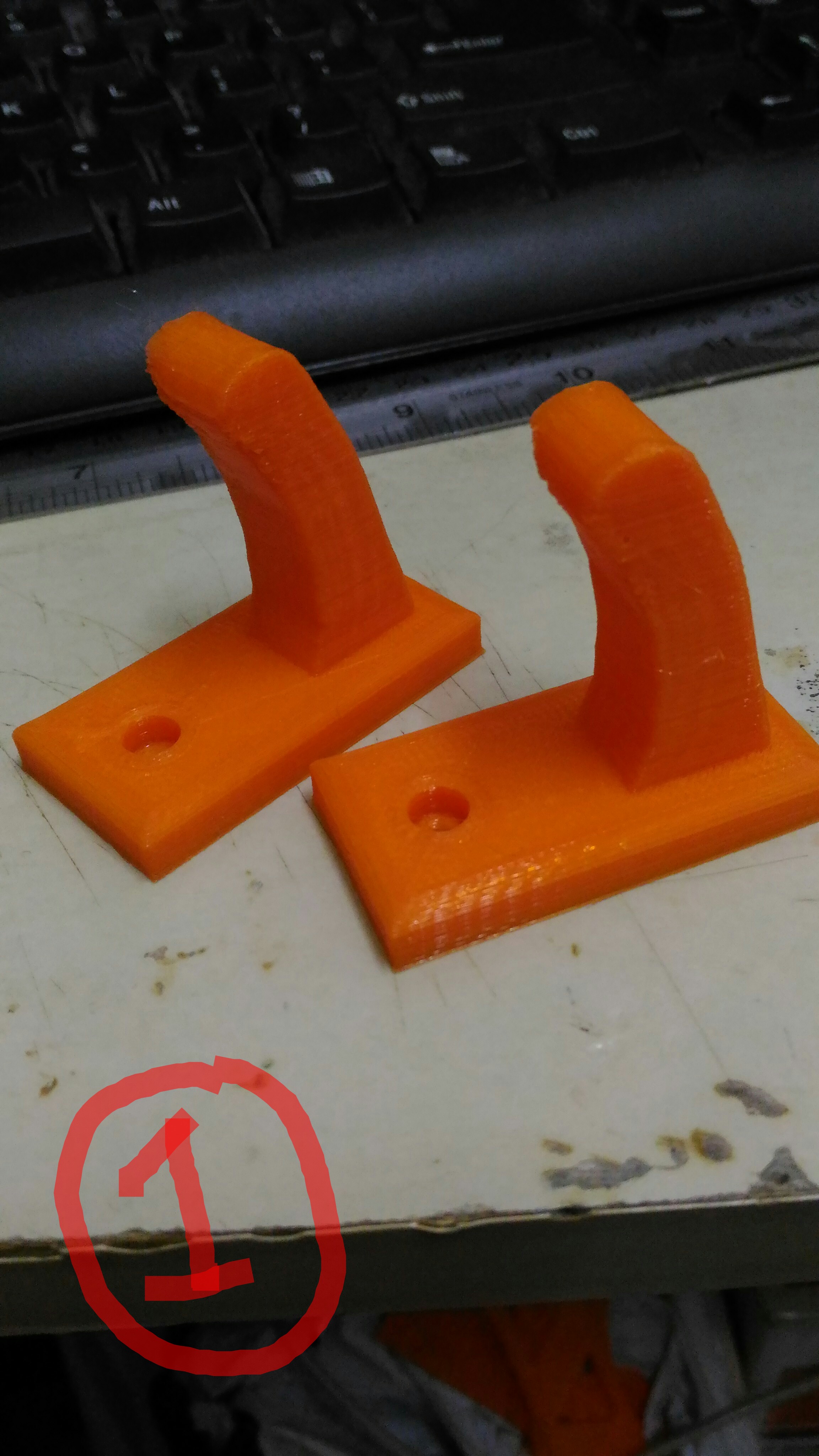

1st picture was print slice with cura Then 2nd picture was print with same
Then 2nd picture was print with same setting but looks very ugly, it’s wrong with slicing?
Yup heat creep most likely
Or a partial clog…
Yes hardware problem, my bowden bearing loose abit
