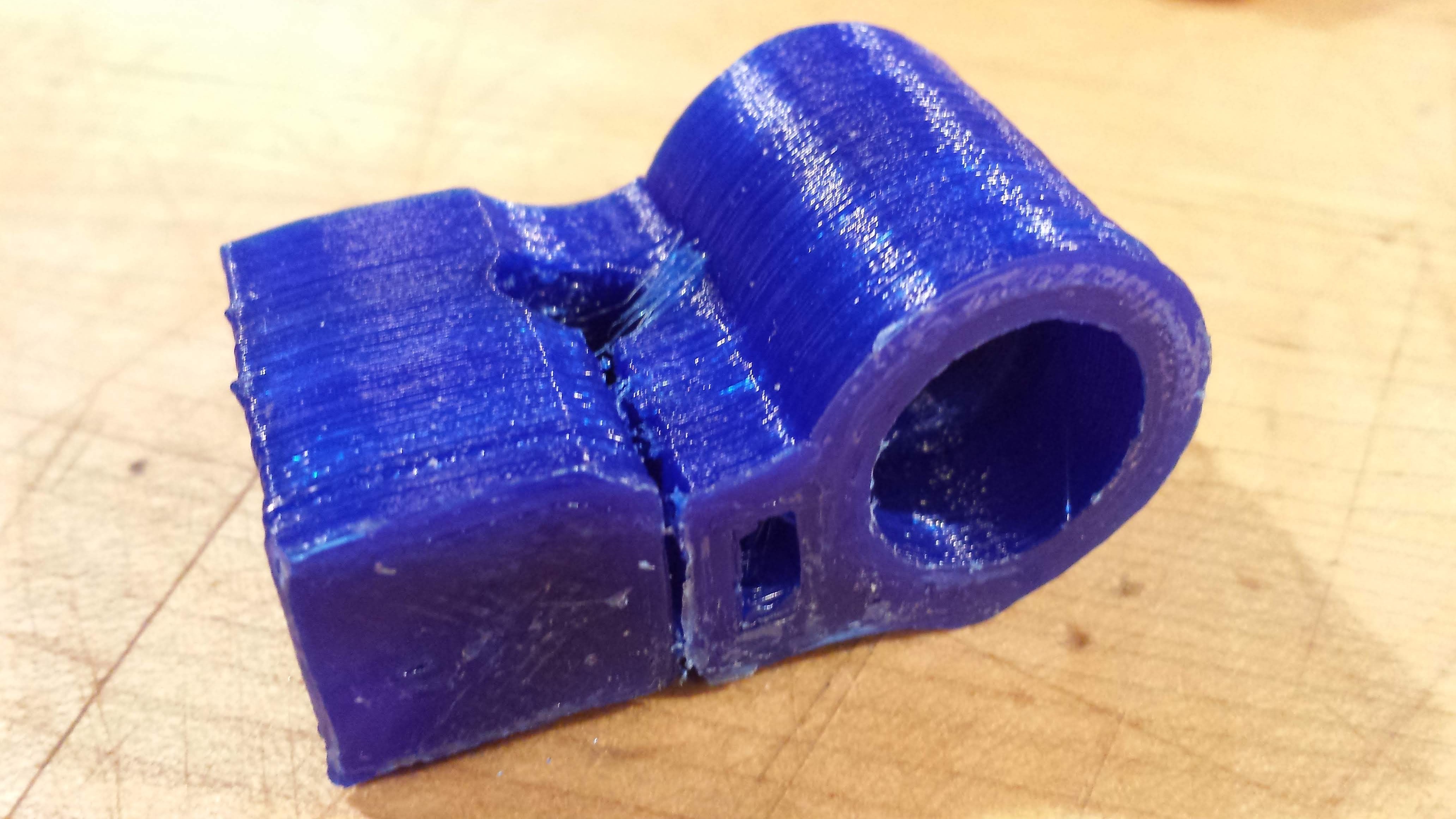

2:05 print, 160 layers, no failures, 100% infil, no retraction. Which makes sence, it printed vases okay, and hollow squares…It’s even reasonably dimensionally correct. (Correct enough that I’ll run a drill through it and call it good.)

The 100% infil was to reduce the number of retracts in the closest part I had in my library to test the theory that it was the retractions that were causing my problems. I’d love to reduce that somewhat, if only to save some filament and time.
