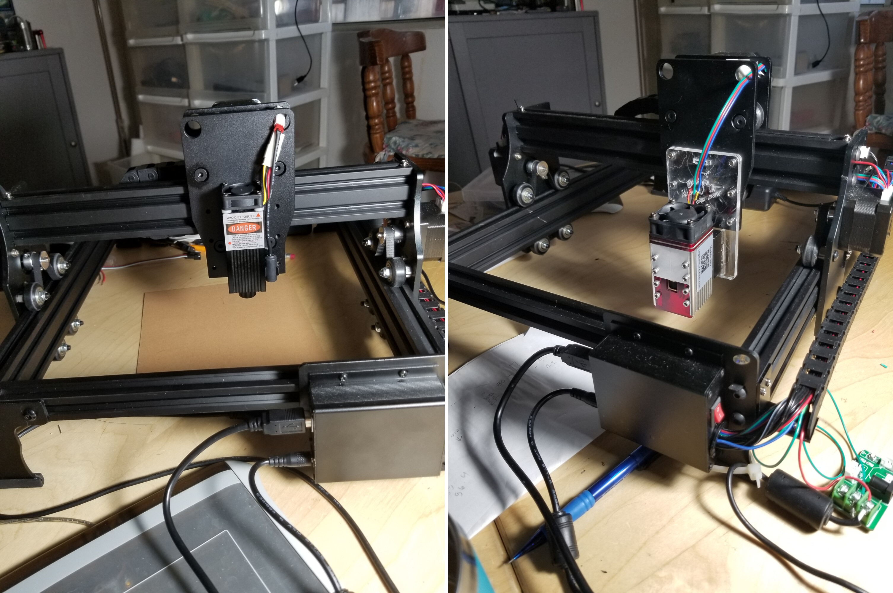

I bought a pair of these $80 lasers from Amazon last year and put a NEJE 40630 laser on one of the pair, left one is stock…
I had to make the mounting plate, most of these have no standard mounting. And the control board couldn’t provide the current for the new module, so I have the board on the right being where power for the laser is connected…
I’m sure you can upgrade the laser/control board, but that 90% of the machine… ?
Don’t bet on it being a plug and play operation.
Good luck
