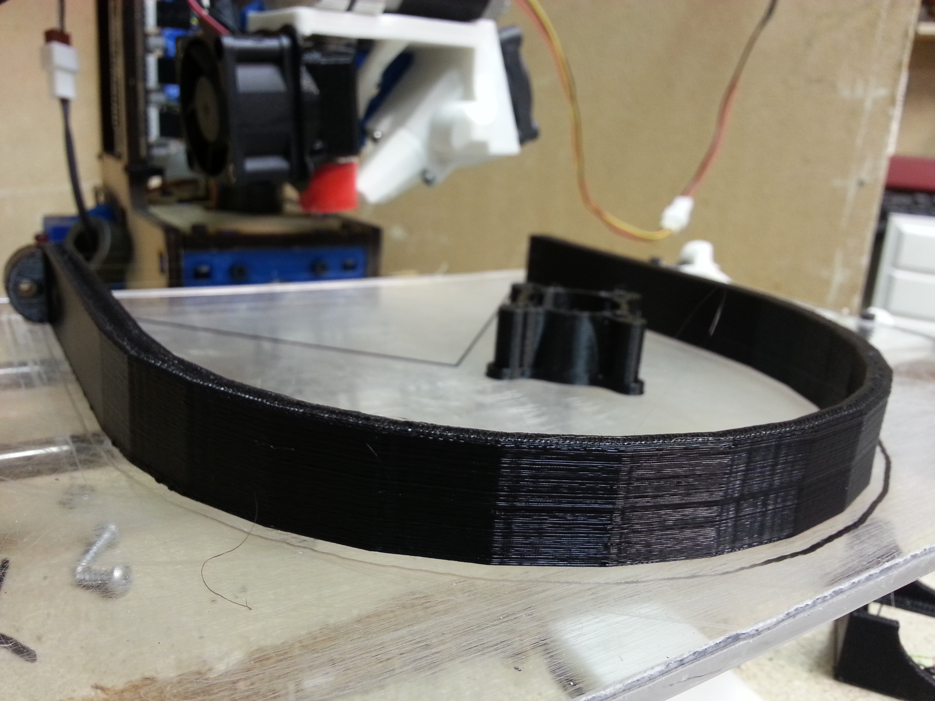

2 hour print at 60mm/s! Thanks @Printr_bot for your help!
With the replacement hot end I was able to back off both pinch roller tension and extruder stepper current while still maintaining full speed.
Great to hear!! Are you using the Ubis 13s now?
What type of help did you receive ?
@Griffin_Paquette Yes, at least I think so. It’s the metal hot end - my ceramic one seems to have worn out (even after trying a replacement tip). I figured the replacement hot end that they sent me (arrived yesterday) was the same as the starter kit (which isn’t quite up and running yet). So I installed that one. The only difference I can see between the two is that one’s heat sink is black and the other isn’t.
I also received a better extruder (just the aluminum - no stepper) but as noted in previous discussions, I don’t have room for the extended arm - so it’s on standbye until I redesign/reprint the Y axis head/arm assembly.
