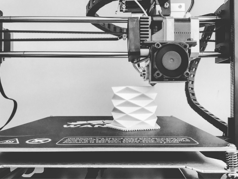

2 hours and 40 minutes to print that vase.
3d printers are too slow!
What you an entrepreneur?
For that I need 10 minutes lol. You have to use the settings tab in your slicer sir
What is speed? 30mm/s?
speed: 40mm/s
layer height was pretty thin
Looks like you have a pretty beefy machine, I bet you could kick that up to at least 60mm/s.
but what’s about the quality?
What kind of printer are you using, what material, what hotend temp, and what layer height are you printing with?
Have just printed several vases in PETG and a 250mm tall vase takes around 50 min. in vasemode ,but I use 1mm nozzle and 0.6 mm layer.

@Domenico_Montaruli The trick is thicker layers with larger nozzle. Thick layer lines are not a sign of bad quality, on the contrary. You may try a e3d v6 with volcano and you can print very fast.
In time you’ll get more comfortable and get better speeds. When you get more confidence in your bed level, you can dispense with the raft. You can probably set it faster too without sacrificing quality.
