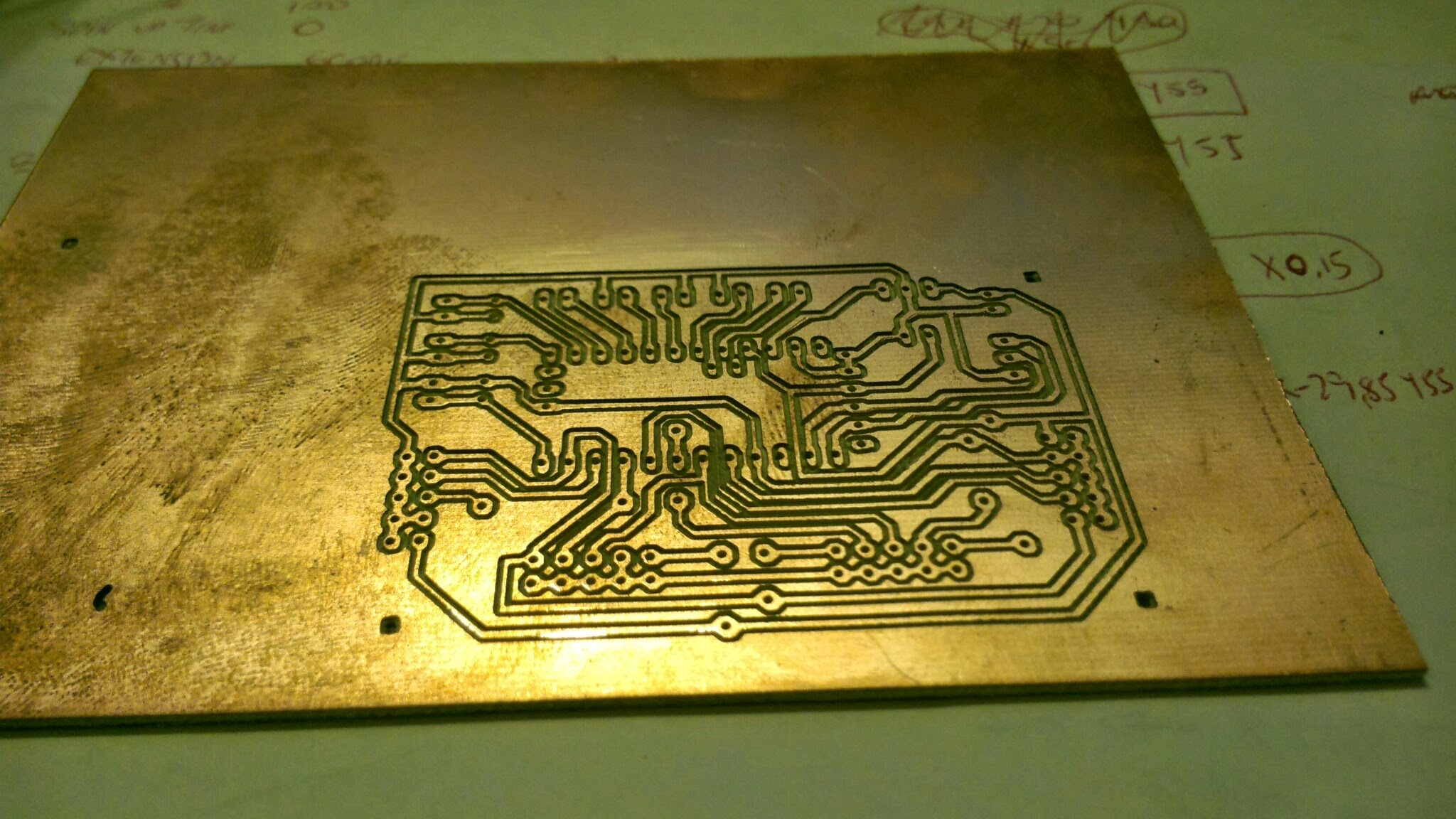

2nd test, but without leveling yet.
2nd test, but without leveling yet. Some traces are very thin, and I believe that was because the bit was too deep in the board. I’m using a V carbide bit.
But, the conductivity test was ok.
