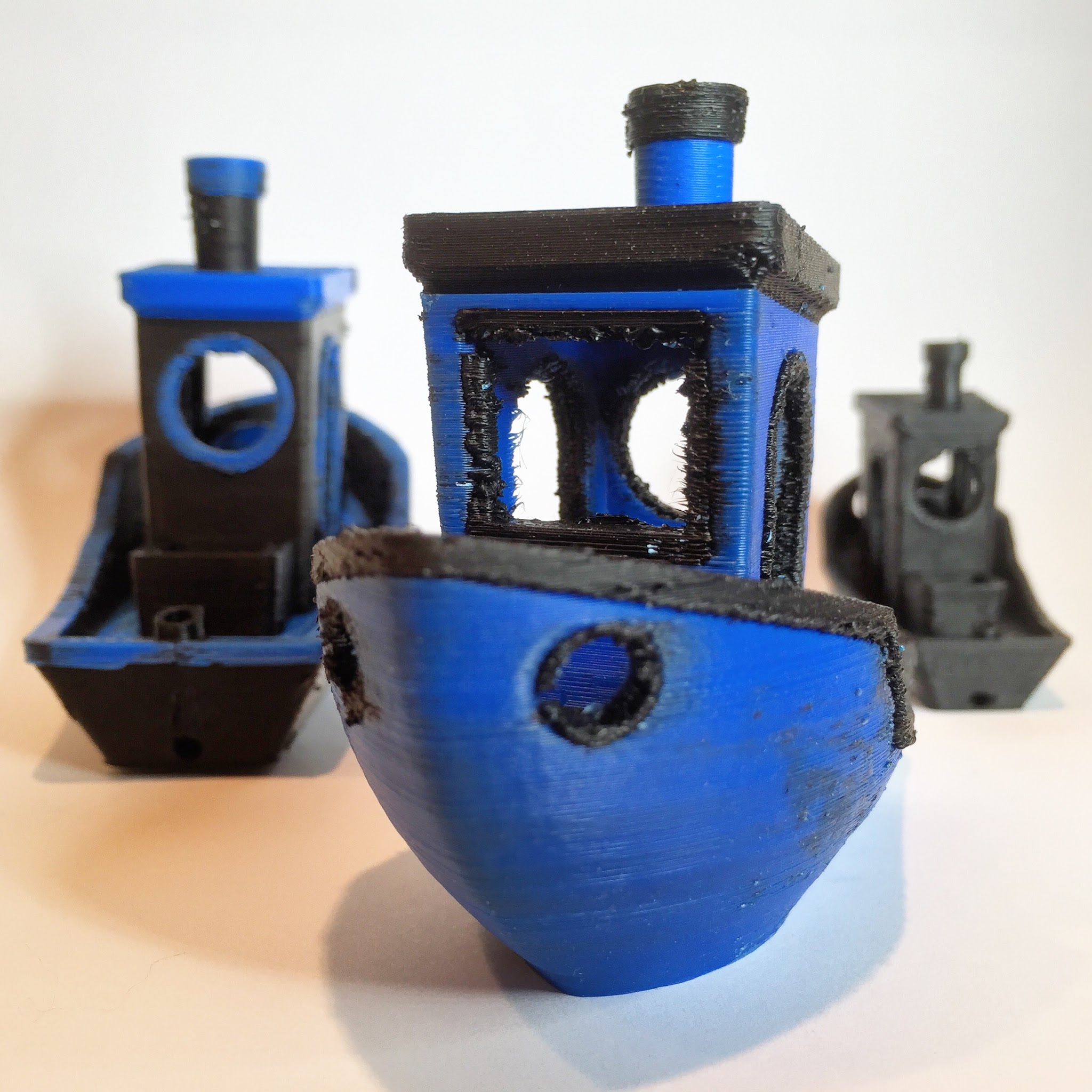

3:d try on the dualprint 3dbenchy, inverted… Support but no Ooze shield. Blue ABS + electrically conductive & flexible TPU. Scale 1.5 , 0.7mm nozzles, 0.2mm layers, Makerbot Replicator dual + Simplify 3D
LOL yes its not a perfect print… Please show us your experience Jesse (not PLA+PLA)
