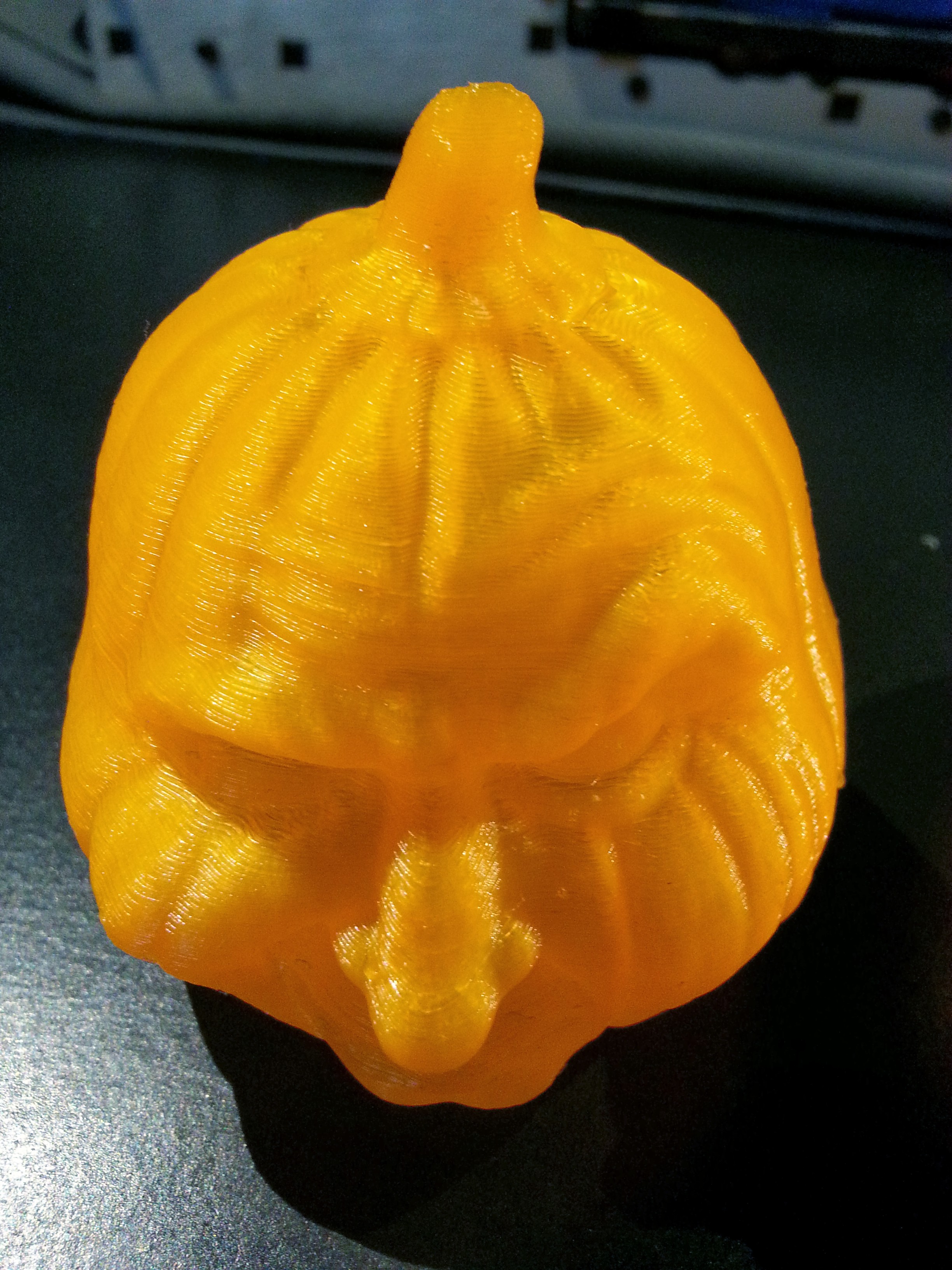

I’m new to 3D printing, so I wanted to try out different slicers. I took the same STL file (http://www.thingiverse.com/thing:172083), which I scaled and fixed in Netfabb Basic, and put it through all three slicers. I kept the settings as close as I could figure out through the different user interfaces (0.2mm layers, 3 perimeters, 0% infill), and exported the gcode. I loaded each into Repetier-Host, and printed them on my PrintrBot Simple.

This print probably came out the best of the lot.

The Cura print quality was on a par with the Slic3r print, but more opaque; probably due to the “infill” on each layer after the perimeters.

Contrary to what I had expected by reading about slicers, the KISSlicer print was the worst of the bunch.
