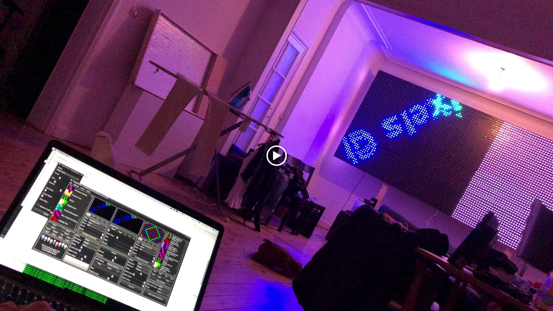

3072 pixels via glediator esp32 via wifi.

Code finally done up to 64 universes here I use 35 of them missing/deleted image from Google+
I have also made a little java program that produces pixel mapping for glediator.
@Yves_BAZIN now you are definitely crazy! I can not imagine how this can work! :scream::scream::scream:
@X-WL1 hello using the subnets :wink: if you define the address of the universe as 0:1:22 for instance the incoming universe (on your controller) will have the number 38 (1*16+22).
I will clean my code and publish
@Yves_BAZIN this I know!) how does a controller manage to process such volumes? increased the wifi buffer?
@X-WL1 no :wink: increasing the buffer does it change anything. The tricks are the following
  1. put the loop to gather all the frames directly as part of te aren’t.read() function. This help in avoiding losing frames I have a buffer for the frames within the class now
  2. once I have all the frames. Execute the fastledshow on the second core of the esp32. Hence the program reads packets at the same time as the display is done.
