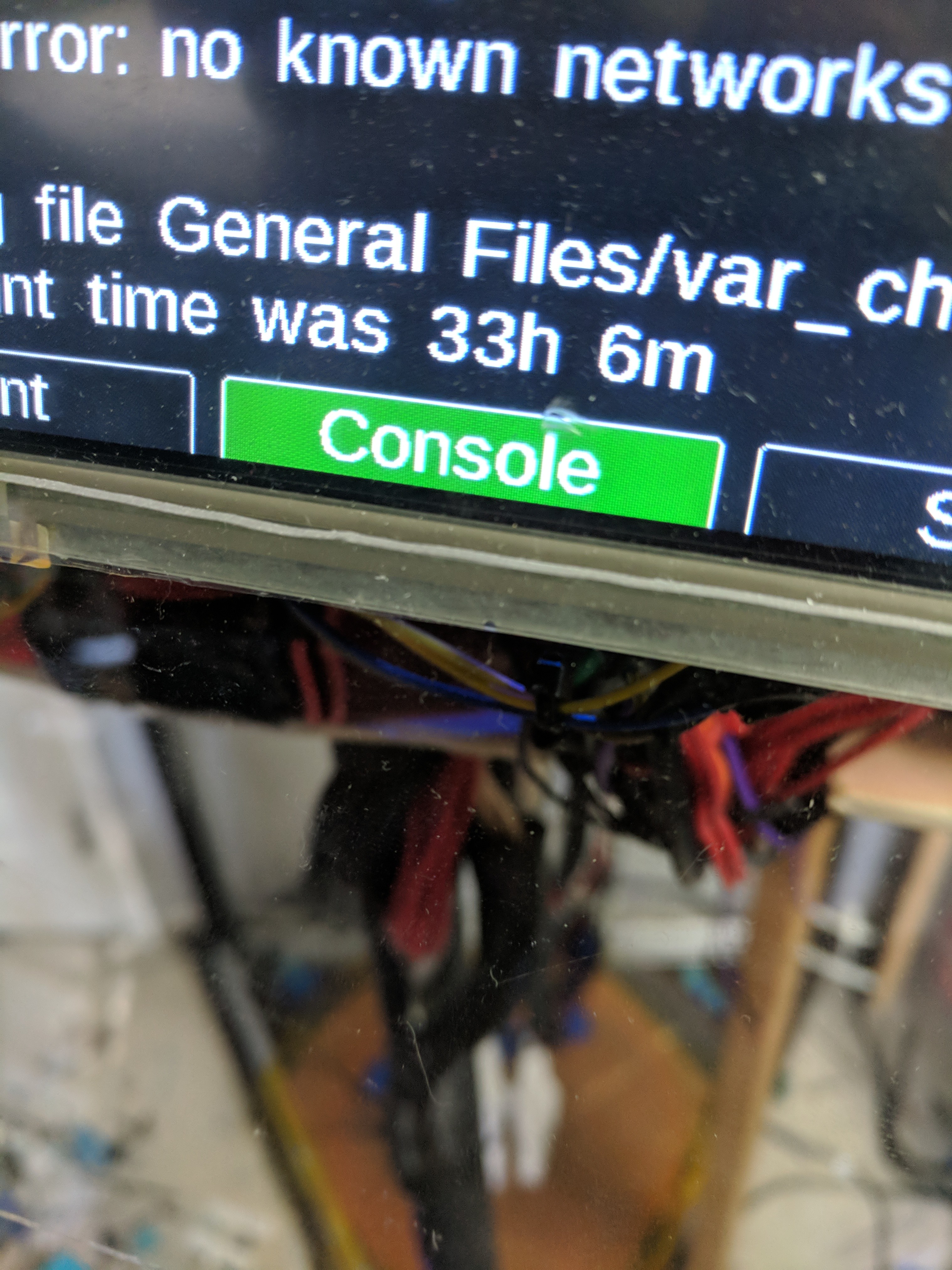

33 hour print... Successful! Think I can say my extruder issues are resolved.
33 hour print… Successful! Think I can say my extruder issues are resolved.
Why was something like that 33 hours though? Wow. Dense infill? Super low layer heights?
@ThantiK , right on the head on both points good sir. The part is quite larger than the pics let on too. A bit longer than my :vulcan_salute:t6:
