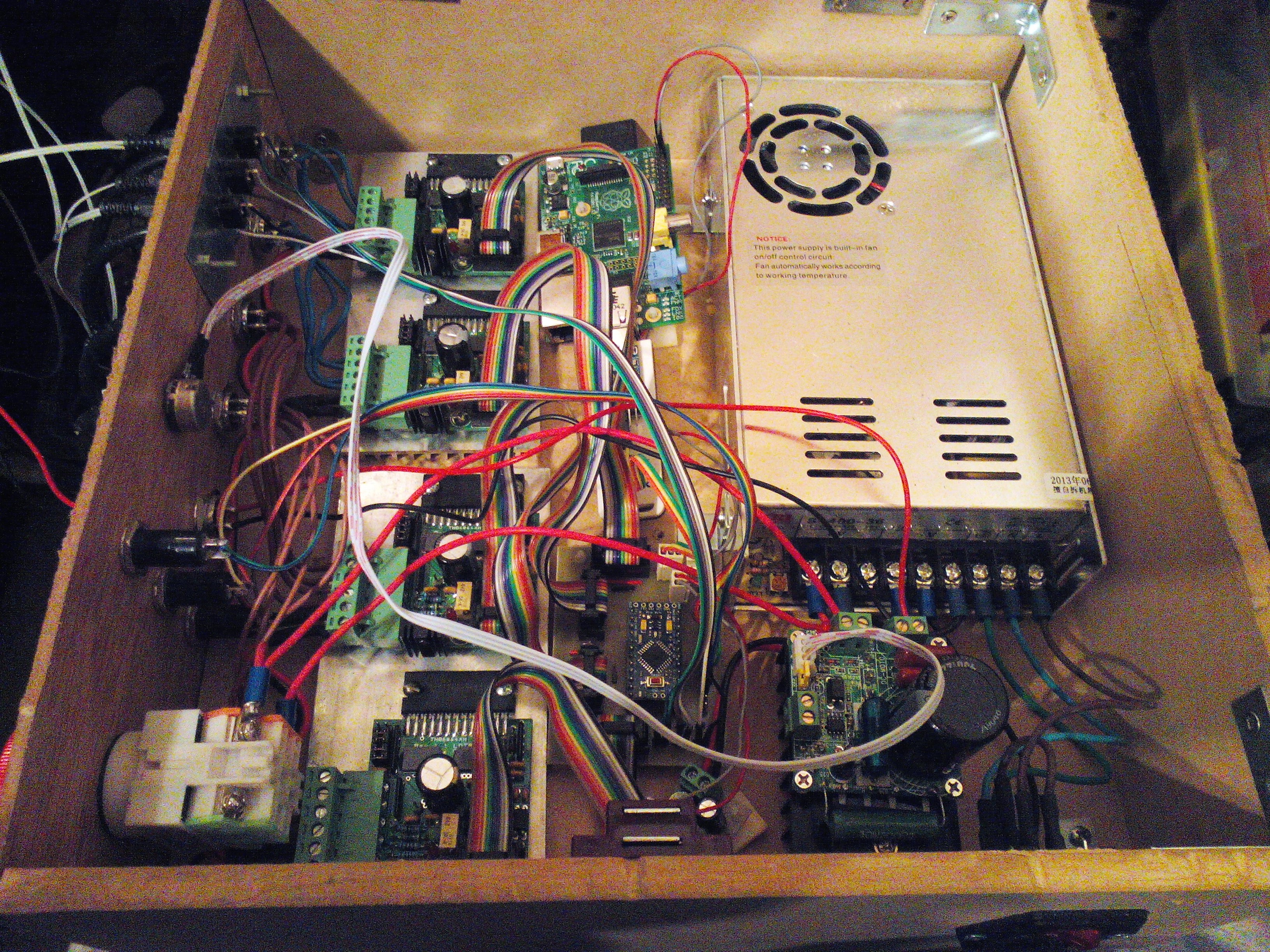

36v 11A + Spindle controller + Arduino w/ grbl + 4 stepper drivers +
36v 11A + Spindle controller + Arduino w/ grbl + 4 stepper drivers + RasPI
Nice setup. I must say I’m glad I went with TinyG right away, as there are so many cables to keep track of. Still working on a housing for it, but I found out that milling ABS was too nasty to continue.
PSU: http://www.ebay.co.uk/itm/36V-11A-400W-DC-Regulated-Switching-LED-Power-Supply-CNC-WITH-CE-/160802121156?ssPageName=ADME:L:OU:US:3160
Spindle controller: http://www.ebay.com/itm/181111622869?ssPageName=STRK:MEWNX:IT&_trksid=p3984.m1439.l2649
Mini Arduino: http://www.ebay.com/itm/New-Pro-Mini-atmega328-5V-16M-Replace-ATmega128-Arduino-Compatible-Nano-/130839929399?ssPageName=ADME:L:OU:US:3160
Stepper Driver: http://users.skynet.be/ldt/CNC%20electronics/THB6064_spec_1.1_descr.html
38v to 5v regulator: Self made -> https://www.dropbox.com/sh/np1pvy491v8zx79/suvnYcy45L
Arduino breakout: Self made -> https://www.dropbox.com/sh/np1pvy491v8zx79/suvnYcy45L
eStop: http://www.ebay.com/itm/New-Emergency-Stop-Switch-Push-Button-Mushroom-PushButton-/230803687481?ssPageName=ADME:L:OU:US:3160
