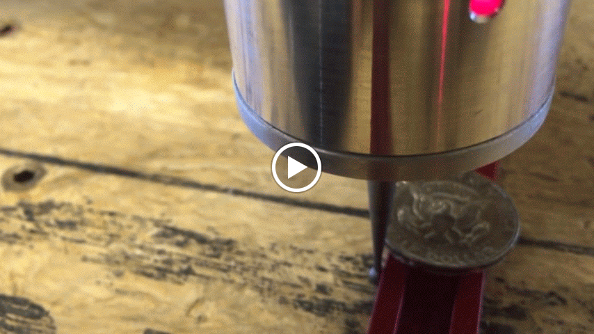

3D Digitizing with LinuxCNC.
well, that’s interesting. What is it doing? Building a height map with a touch probe?
Basically yes. You give the script the basic dimensions of the object you want to digitize and it creates a ‘toolpath’. As it goes to the pre-plan positions, it marks a spot where the probe is triggered to a file. With that file (cloud map) you can make a 3D model.
That’s cool , I would like to play with that
