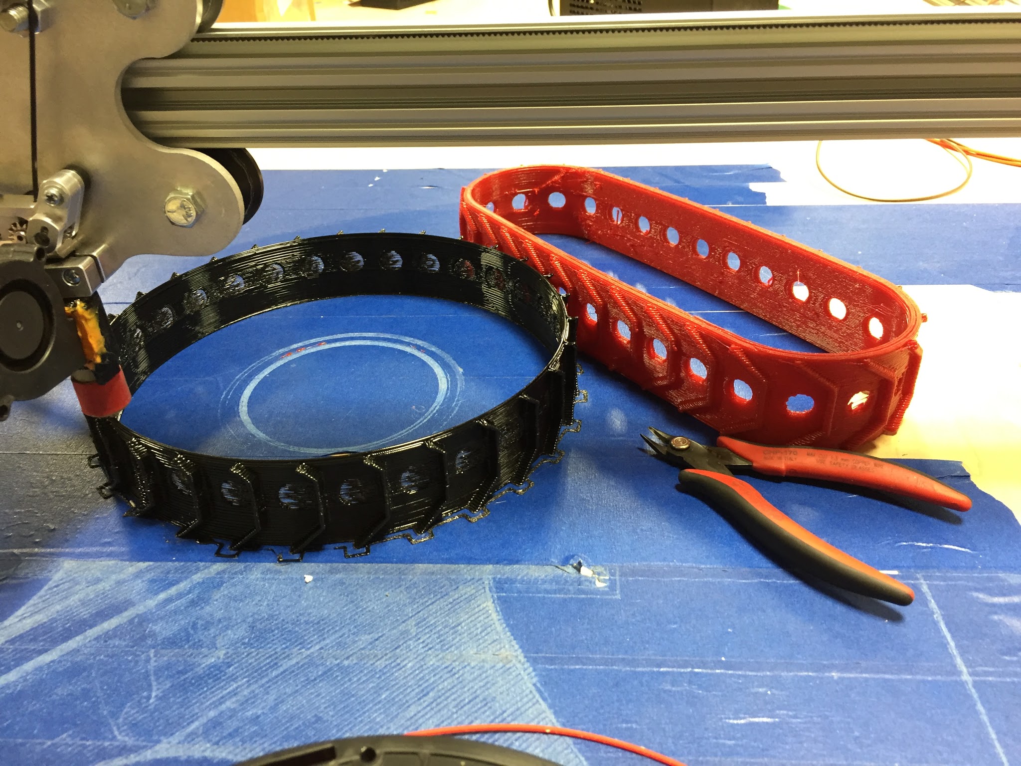

Start with the treads ;). We print them in a circle, but curious if anyone can print in a “C” or “S” formation on a smaller bed.
