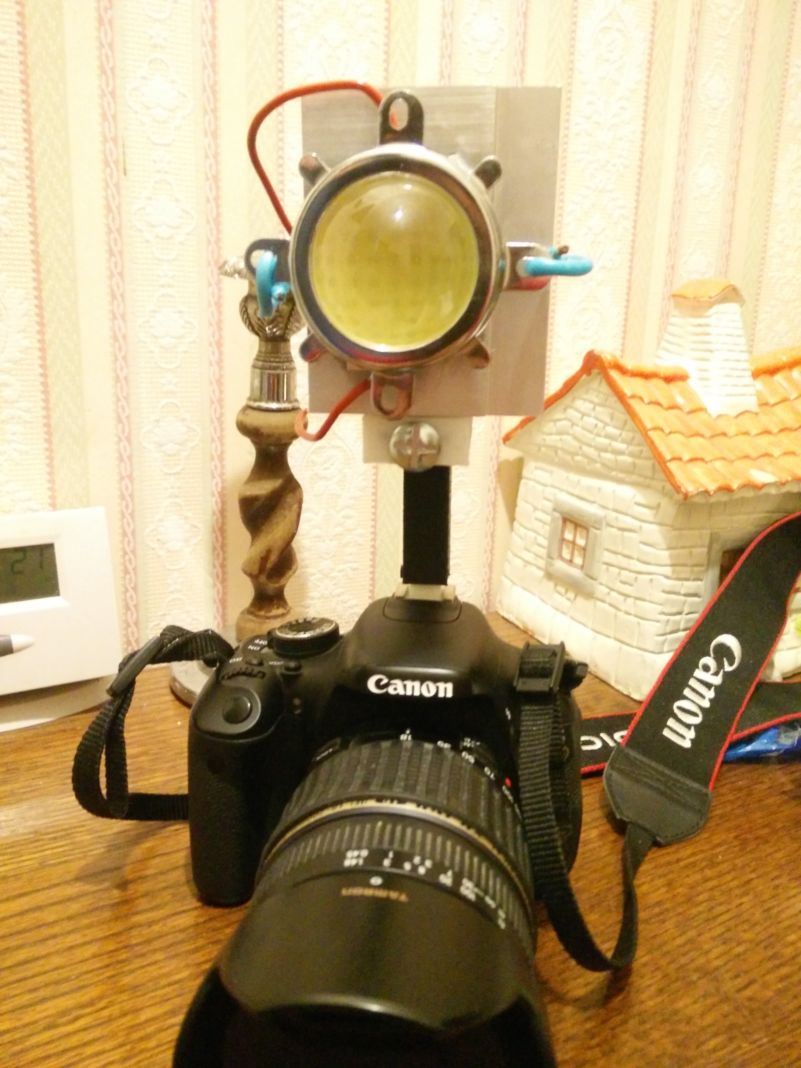

3d printed a custom lamp mount for my 600d! (Designed it in sketchup,
3d printed a custom lamp mount for my 600d! (Designed it in sketchup, I haven’t tried anything more advanced yet)!

Ouch, that’s a lot of mass to hang from a hotfoot mount…

@Hakan_Evirgen It’s a 100w Led from ebay, about 7500 lumen. You can get them for about 6 euros I beleive.
@Mark_Fuller Yea, it is… But I’m hoping it will be ok, I mean if it’s too heavy I would have thought that my printed parts would break befour the camera mount…

That tiny heatsink will not do for 100W of heat, especially not without a fan!
After all, it was designed to keep a 65W CPU cool with the fan running at full speed.
@Thomas_Sanladerer ​ Shouldn’t there be a lot less heat than 100 W from a 100 W LED? Large portion of the energy should be radiated as light (as opposed to a filament light bulb).
Anyway, isn’t 100 W taking it too far for a DSLR light @seb_seb ​? You will be blinding people, especially with the lens attached :slight_smile: I mean 7500 lm is equivalent to what, 700 W filament bulb? :slight_smile:
@Petr_Sedlacek the actual power that’s emitted as light is almost negligible, the best LEDs only reach ~25% “efficiency”, with the rest being turned into heat.
Considering that these 100W COB LEDs aren’t particularly efficient either, at about half to a third of the light output at the same power as a premium LED, it’s a good estimate to just calculate with the full rated power.

@Petr_Sedlacek @Thomas_Sanladerer ​ It does generate alot of heat at 100w, and I would need a fan, but I won’t be running it anywhere near 100w so not to blind people and so not to require a fan.
@Thomas_Sanladerer ​ Thanks Tom. I never googled the numbers and I was honestly expecting higher efficiency from LEDs.
