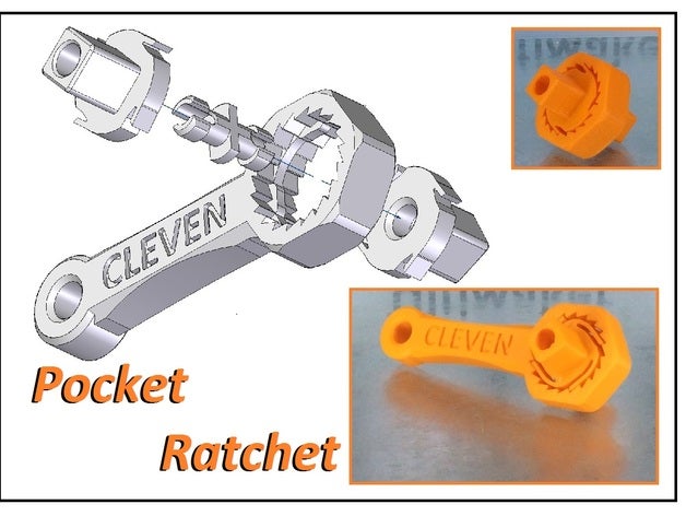

3D printed Cleven’s Pocket Ratchet Wrench and decided to mill out a tray/holder for it out of walnut.
The wrench-
The wrench-
