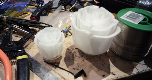

3D printed flower vase for my mother. FastLED demoreel100 is the code used.
3D printed flower vase for my mother. FastLED demoreel100 is the code used. 13 WS2812B running on an Attiny85 and 2 AA
Looks great! Is it able to hold water for the flowers? I’ve been working on something similar, and plan to use epoxy to make it water-tight.
Yeah that was the second thing i tested. I filled it up with water almost to the top and let it sit there with a few flowers to ensure no water leaked out
It has 7 layers of PLA on the outside
I’d suggest wiping a thin layer of clear silicone on the inside. PLA will absorbs water… And you don’t want the LEDs etc to get wet. (I got this tip researching vases on thingiverse)

Nice lol. I didnt think anything of it because it was food grade PLA and dishwasher safe. But yeah that does make sense it would absorb it overtime
