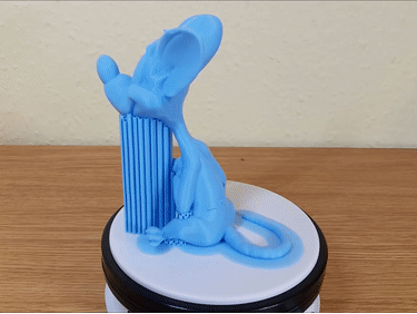

3D Printed Pinky (Pinky and The Brain) - Before/After Supports Removal. By SparkyFace5. layer height 0.2mm, 5h+ print, prusai3mk2, manually added supports and 15 skirt outlines in s3d.
How do you manually add supports?
@Kevin_Danger_Powers Simplify 3D has an option for it
@Elliot_May I heard that program costs money. Is there a free version? I’ve been using Cura and it works well but the ability to add and remove supports would be nice.
No free or even trial version of simplify - but I have never regretted buying it
We love the skirt/brim option. But sometimes to make sure that skirt/brim covers the support area we have to apply a big amount of skirt outlines. Is there a way around it? Does anyone knows how to apply skirt/brim to supports? Just to be sure. We stopped using a raft as it damages the print.

@JC_Ouellet Might be. Our task was to make sure that main supports blob was as a single piece. This helped to keep supports attached well to the bed in the beginning and was easier to remove it in the end. Supports will be recycled for sure!
