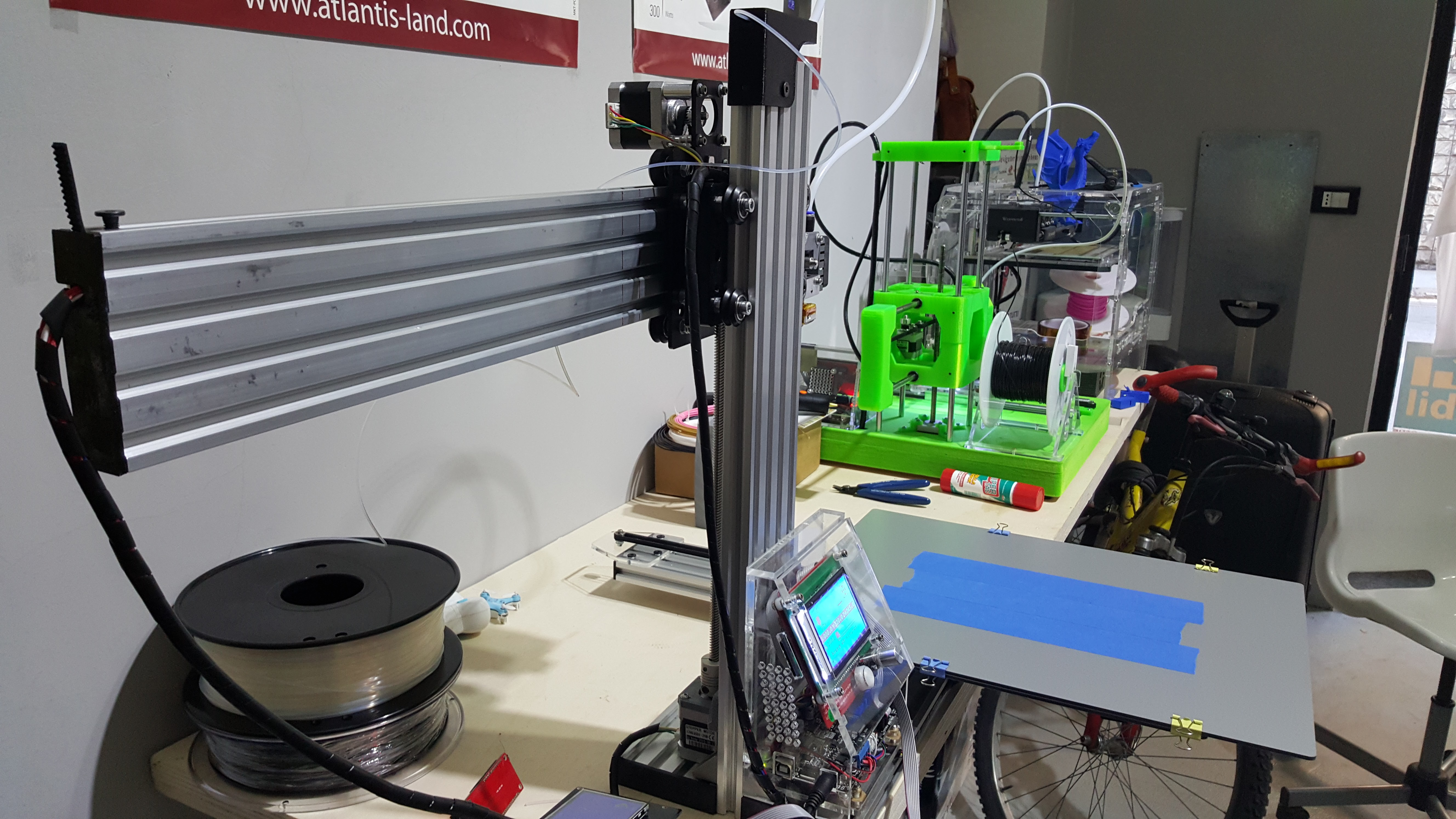

3D printer build with openbuilds parts. We make 50 of this printer.
3D printer build with openbuilds parts. We make 50 of this printer. I want to share this design because is a winer… we use every day. Never fail. Have 30x40cm printing area.

I think I’ll never understand why someone wants to move the whole arm instead of just the print head.
I think it’s a compromise for simpler construction, less parts, etc. I would consider this kind of design if it was designed with the intention of using it to print parts for another, better printer and canibalize itself of ALL its parts.
@Florian_Ford
But that’s the funny point. It’s not simpler! Your whole structure needs to be stiffer if you want to move the mass of the whole arm on one axis. I mean you’ll use bearings for this axis anyways. So the best idea is always to move the lightest part if possible. This way you can make the bearings smaller, the z slide less stiff and you need less mass in the base. In addition you can increase the print speed by keeping good quality. (or even better)
So with this way here you need more parts and they are heavier and more expensive. It simply doesn’t make sense.
Yeah, it would be better off if it was converted to a fixed cantilever arm (like the Bukito). With that much mass swinging back and forth, it’s likely to tip over, and moving the arm outside the build area means that you have that much more space on the side that you need to keep clear in order to use it.
A moving by arm obviously works. You just have to limit its reach. We don’t go over 6" with our simple. And yes, it must be very rigid. Our current Printrbot Simple does have very few parts takes 1-2 hours to build.

If it works you don’t need to FIX it. But this doesn’t mean that it’s the best solution cost and performance wise. If we use your argument for the future we wont see any kind of development :wink:
And yes, of course it works (somehow) . It’s proven at least by your printers. But again, this doesn’t mean that it’s the ideal solution. And it also doesn’t mean that there isn’t an easier solution.
Sorry :wink:
And by the way, the part count if you move the print head instead of the whole arm will be the same. You could even use some of the same parts. You’ll just move a different part.

And that’s exactly my point. I fully agree with this statement! And we already know better ways. Maybe it wasn’t well known 2-3 years ago. But today we know very well that moving mass is a critical point on every 3D printer. And he is on his way to build more of these printers because “it’s a winner”.
So my simple suggestion is keep the most of the ideas and fix the arm on the y axis and then move only the print head instead of the whole arm in the next printer iteration.
There is no need to turn it into a box. And this would change the whole concept. He should consider to change “only” this small area of the printer.

It is not a perfect printer… but is the best for the price. I don’t sell this printer. Is our design. We make 40-50 pieces for a 3d printer hub. The quality of the prints are more then OK. I will post some more pics. The only reason for moving arm was costs. Any deviation of this design bring higher cost of hardware and construction time which will not give a huge quality improvement of the prints.
