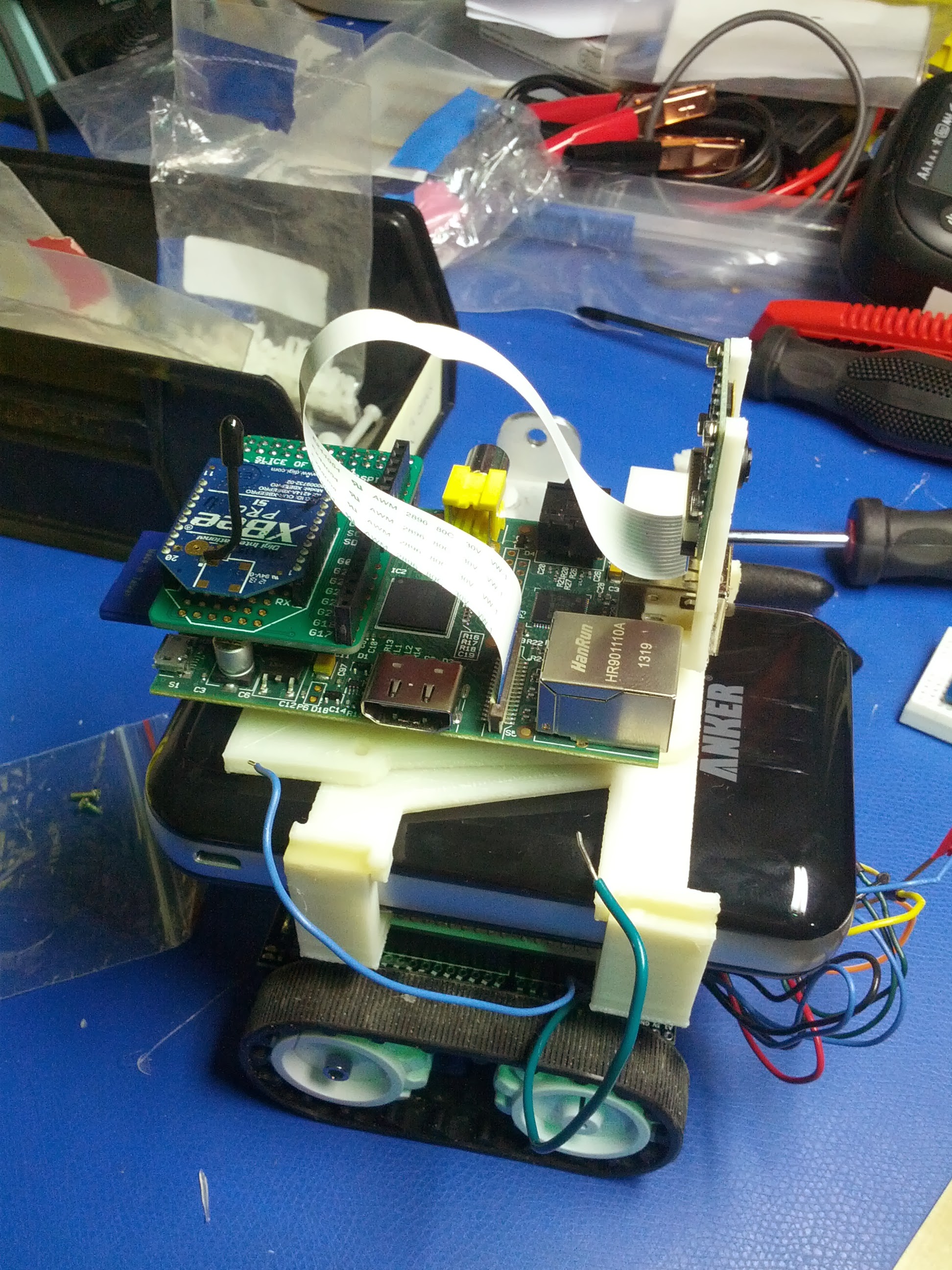

3D Printing a chassis for mini-tankbot using the Makerbot Replicator 2X.
Parts from top to bottom:
  • Xbee Pro
  • Raspberry Pi + 5MP camera
  • Anker 15Ah 5V regulated battery
  • Arduino Uno
  • Pololu Zumo robot + optical encoder wiring nightmare
Could you provide the thingiverse id?
@Jose_Antonio_Vacas_M I haven’t actually put all of it up yet, it’s a custom sketchup model I put together yesterday, here’s the camera mount though http://www.thingiverse.com/thing:239391
Thanks, Where do you get the threads?
If by threads you mean the standoffs and screws etc. for mounting the boards, they’re M3 nylon screws and standoffs lying around the lab.
