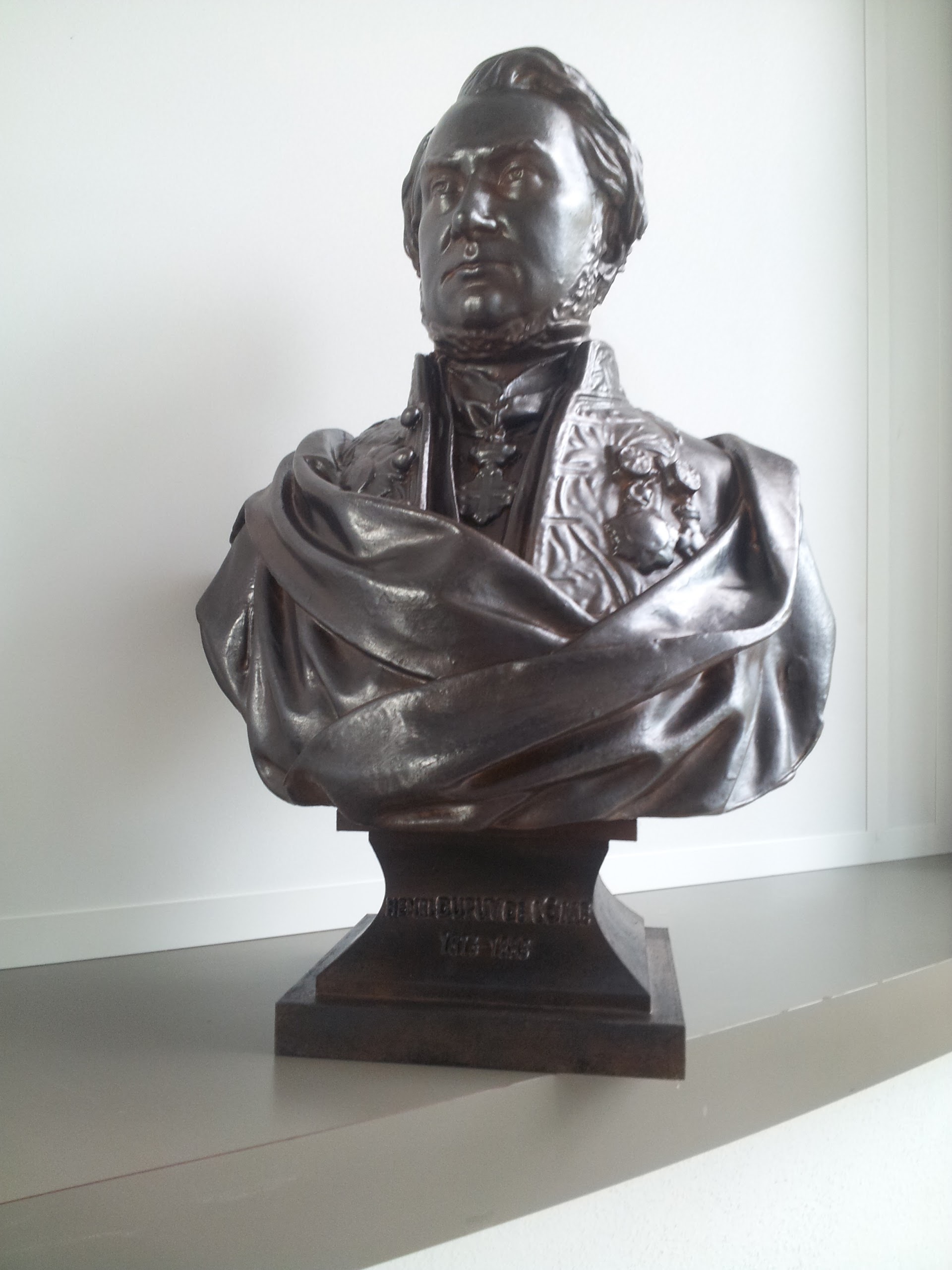

3D printing and bronze finish.
Awesome… What brand of filament? What machine you used? And how you did post processing?
Forgive me but this doesn’t appear to be 3D printed. At least not with bronze filament then polished.
@Adam_Steinmark It says 3d printed and then bronze finished. It could be that they printed it in something else then sanded/filled and painted it bronze.
But It would be nice if they gave more of a description.
I was wondering it it was a 3D printed part that was sanded/finished and then used to make a bronze casting.
Whatever the method the end result looks impressive.
If you zoom into the picture I think there are a few paint spots left over (on the left cheek) from too much paint. At least it looks like it.
Bonjour à vous tous,
C’est bien une impression 3D Filament, imprimante stratasys, puis finitions à base de résine et de patines (finition manuelle).
Hello everyone,
It is a 3D printing Filament, stratasys printer, then finishes based on resin and patinas (manual finishing).
best regards.
