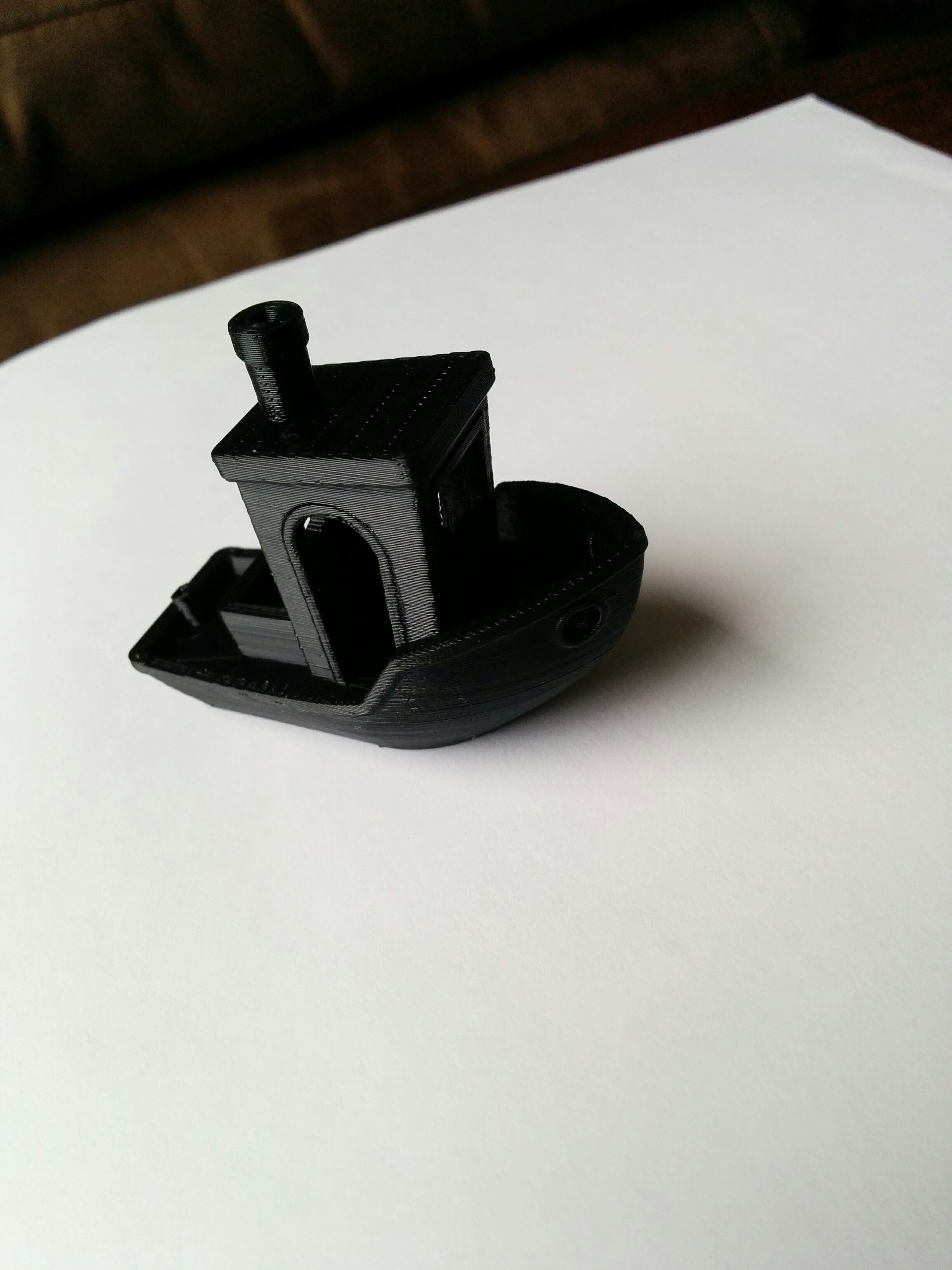

3dBenchy time. First one detached halfway through. Was printing ABS and left the ceiling fan running. Now to enclose the build area.
What’s your secret?! I’ve never gotten a 3dBenchy to come out that well.
@Erik_Scott To fine tune the extrusion steps, I ran 100mm through the hotend while the extruder(hot) was in the middle of the bed. This would be an average point for min/max on x and y printing via the bowden. I saw other methods to set extrusion steps but this seemed to make more sense.
