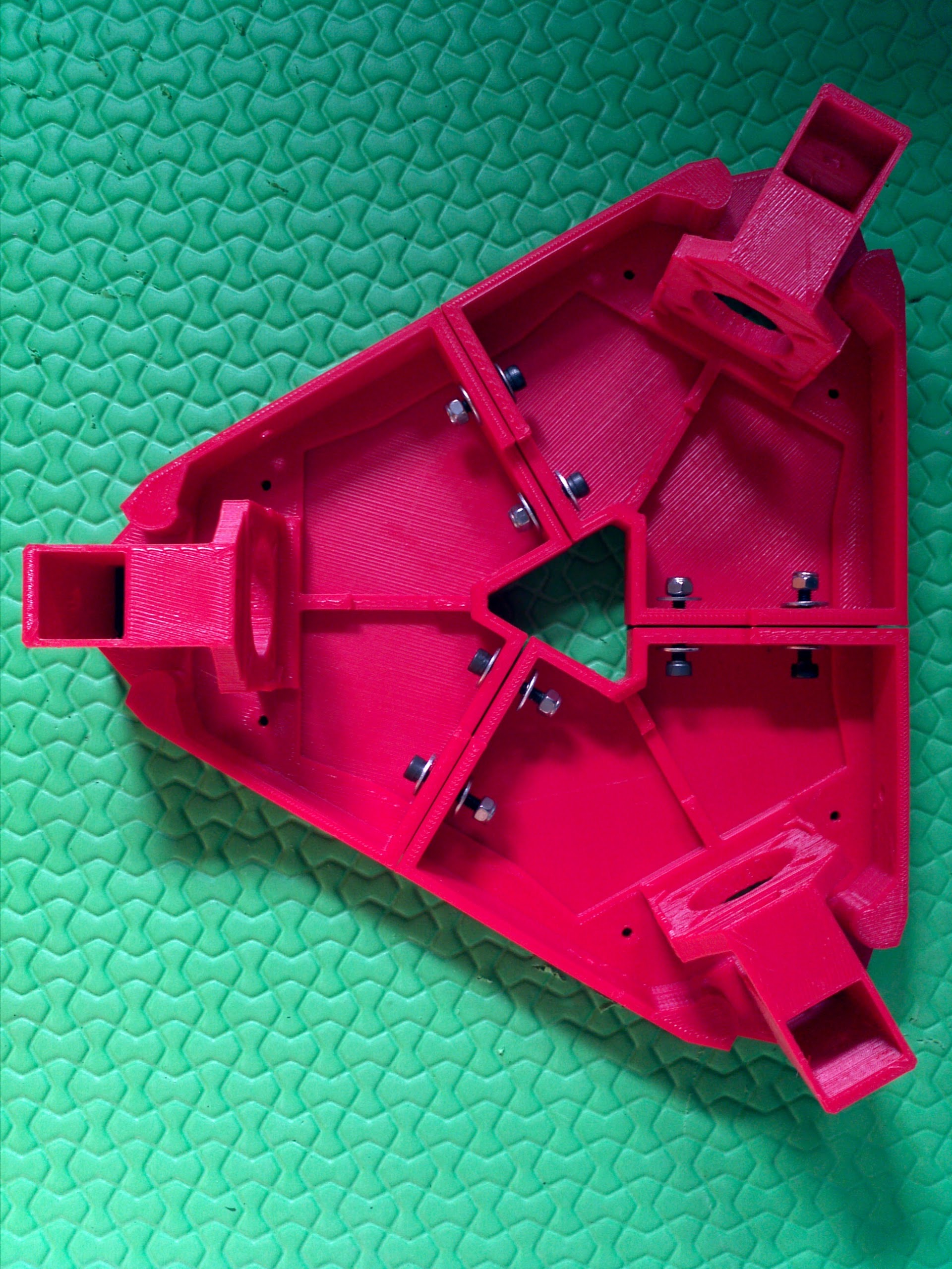

3DR parts print started! This is a square tube version (no 20x20 alu extrusion
This is a square tube version (no 20x20 alu extrusion here).
I have almost all the vitamins, the only missing things are the ball connectors and the springs.
Im thinking on using 3mm filament, @Richard_Horne , is that going to be a problem?, i have a bowden tube for 3mm filament.
Nice! @Nicolas_Arias #3DR Modifications Already ! great stuff I’ll have to get cracking on the next blog post :slight_smile:
You did work out the motor wires go down the tube then.
looks great, can you please share your base files as I have a heap of 20x20 tube.
ThX
@Richard_Horne , yeah, i saw that the cables go inside the tubes. i plan on drilling a 15mm hole on the inner side of the tube, so i can pass the cables.
Also, i have to modify the top cover, so theres access to the inner part of the tube to put the nut that holds it.
forget about the last bit (top cover) i see that there already holes!
@Auzze_Auzze give me a few days so i can assemble the printer, once i do that i will publish the files, if @Richard_Horne agrees!

Tubes and smooth rods are cutted. No i need to print the top part so i can assemble and do the tube drilling.
i think that when i manage to get the basic structure and check that the top and bottom parts go as expected with the square tube i will publish the files
