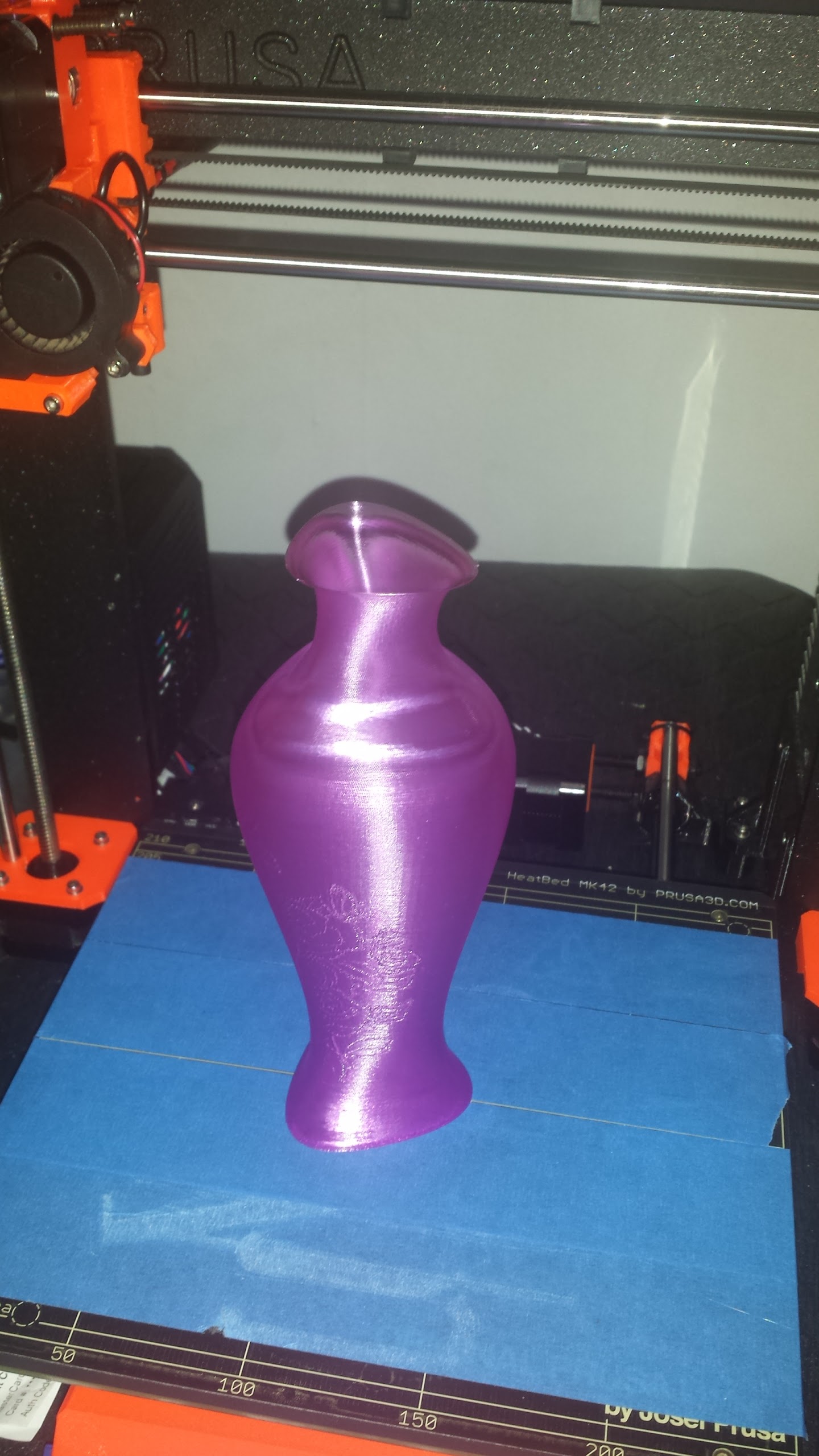

4 hours and 2 minutes later. Velocity painted vase #4 :slight_smile: my second successful print using velocity painting. My mother loved it lol

@Kevin_Danger_Powershttp://velocitypainting.xyz thats the main webpage. Its a program that lets you add images to a model by editing the gCode and changing the acceleration of the printer. Its not too hard to start with it and this vase model is on there to help you get started :slight_smile:
@Kevin_Danger_Powers basically it post processes a gcode file from your slicer to add an image onto the surface of the print by varying the velocity significantly in the portion of the image. It requires black and white image (not grayscale).

Wat is this
A vase with a velocity painted rose on the side lol
