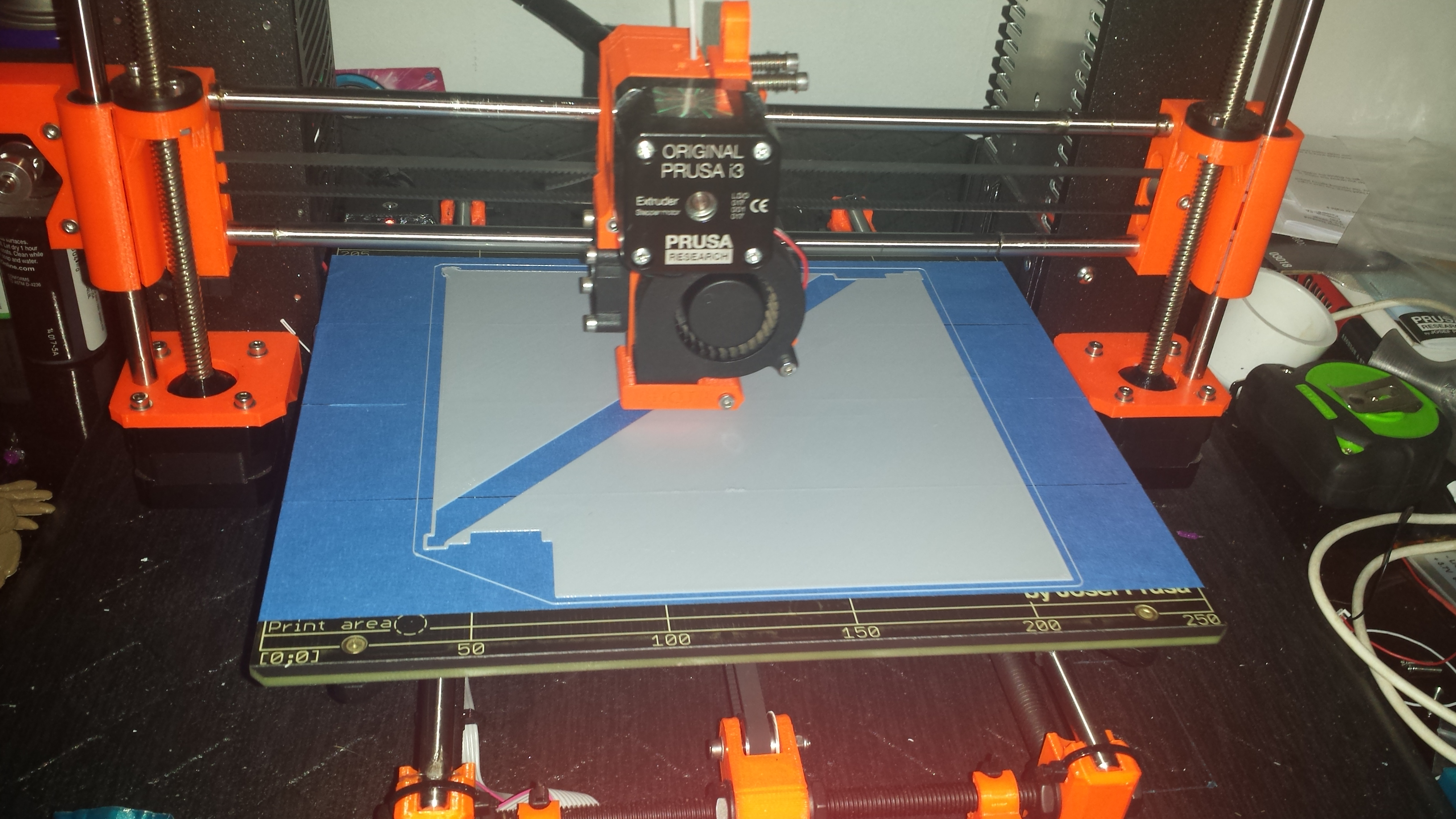

48 minutes and still on the first layer. Dang....
48 minutes and still on the first layer. Dang…
Blue tape on PEI?
@Tomas_Vit depends on the material. I use blue tape for Spoolworks Edge & PET/G because otherwise it sticks too well to the PEI and is almost impossible to remove.
@Jon_Gritton Under PET(G) or CPE I use windows cleaner (glue for big parts) and under flex materials it’s faster/cheaper (than blue tape) to use separation layer of glue. (It’s no problem to clean it from PEI with common alcohol.)

@Tomas_Vit I’ve used Elmers Glue as well in the past. To be honest, it’s mostly about simply remembering that these materials can’t print directly onto the PEI. What they should print onto is then another memory issue and blue tape seems to be a reliable solution for most materials.
