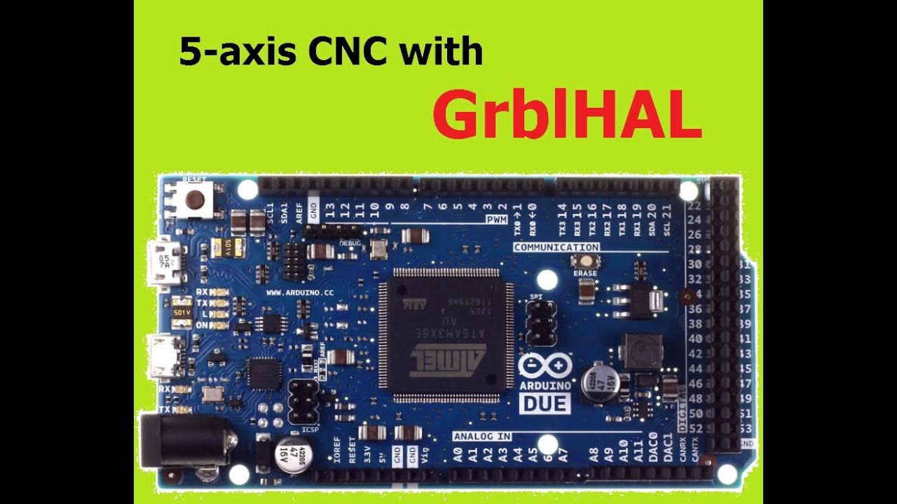

I have now implemented the corresponding interface, so that you can run first tests with GrblGru.
In this context I would like to point out the possibility of the extended macro creation.
With it all new G- and M-codes can be tried out now.
On hardware I was able to put a 32-bit Arduino DUE into operation.
The short video shows the necessary steps from downloading the bin file to flashing and then starting it in GrblGru.
