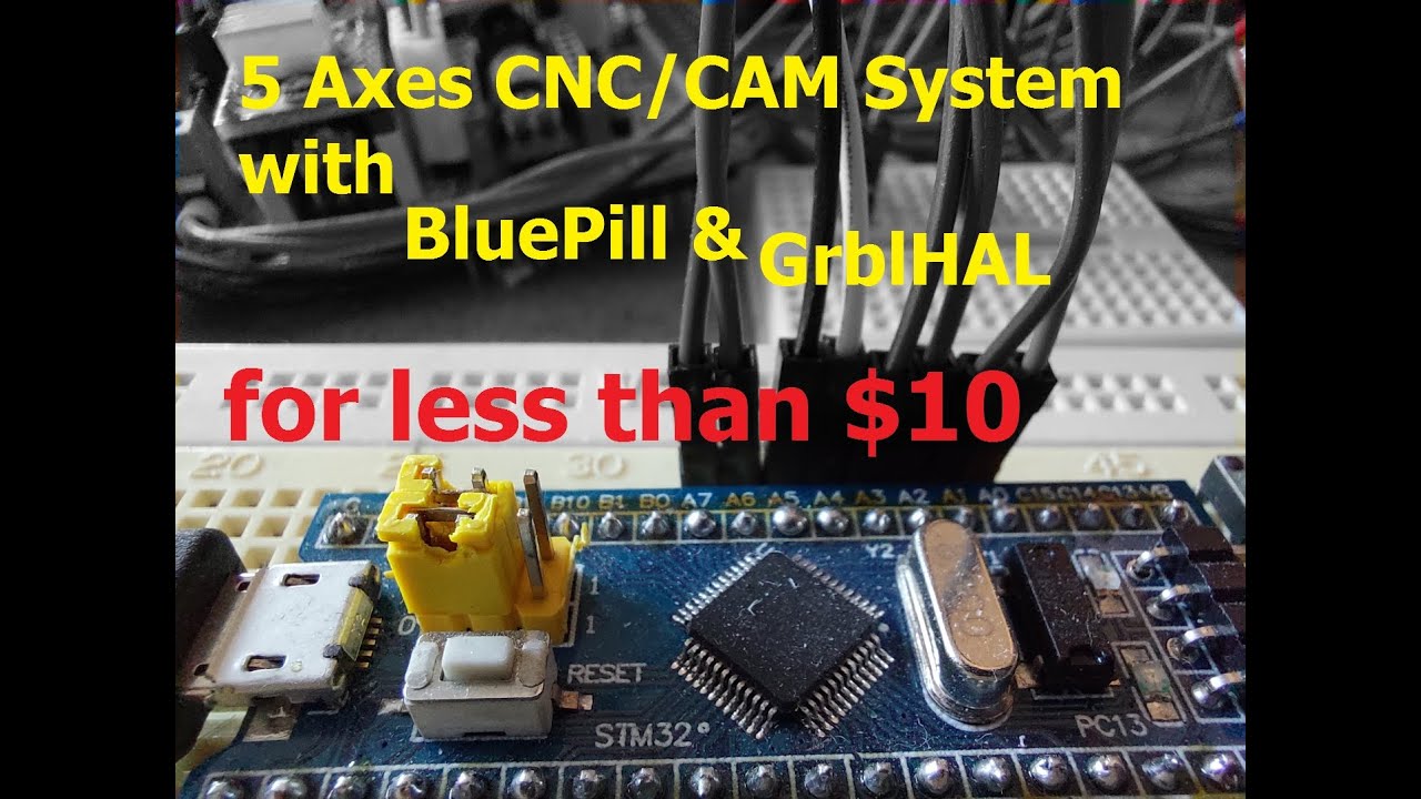

5-axis CNC System with BluePill and GrblHAL for less than $10
Hello all,
after I presented the programming of the Arduino DUE for GrblHAL last time, today I want to follow up with the programming for the STM32.
The STM32, also known as BluePill, is often available for less than $10, GrblHAL and GrblGru are free.
Considering that you get a 32 bit system for 5-axis for that, that’s not bad, is it ?
On suggestion of users I started to create a list, in which I write down a few key points to the changes of the respective version.
This list “Release notes” is available on my website from now on, so that you can check at any time if an update is worthwhile for your specific application.
The current changes of version V5.0.9 mostly concern the lathe operation. I will report on this separately at a later date.
