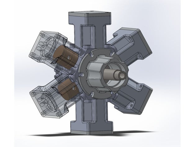

6 cylinder radial 'steam' engine 3d printed, with some metal parts and inserts.
6 cylinder radial ‘steam’ engine 3d printed, with some metal parts and inserts. It’s a work in progress, no instructions yet so its like a 3d puzzle of an engine! I will post some exploded view diagrams of the parts order of assembly soon. It still needs the cylinder piston sleeves figured out… no compression as it is now.
I like it.
Any possibility that you’d use the plastic parts as investments in a casting?
That little engine will make a lot more torque if you can put hotter steam into it.
Yes you probably could do that. Its a 3d model of a ‘Potty 3 cylinder radial steam engine’, modified for 6 cylinders and 3d printing. I have already machined it in steel and aluminum from common rod and bar sizes as a 3 cylinder, even with mill and lathe accuracy and very good compression it’s not something built for driving a mechanism with much torque its just a model of a proposed radial steam engine, I am not sure this design was ever even used for anything in an industrial capacity. On my metal model I bent the offset on the crank shaft running it way to fast showing it off to some people, still runs on a breath but a slight wobble now with any kind of high pressure. The size of everything especially the rods and offset shaft make it just a model, not a real engine. Harder shafts of drill rod maybe, I leave that god awful task of cutting that stuff to someone else!
