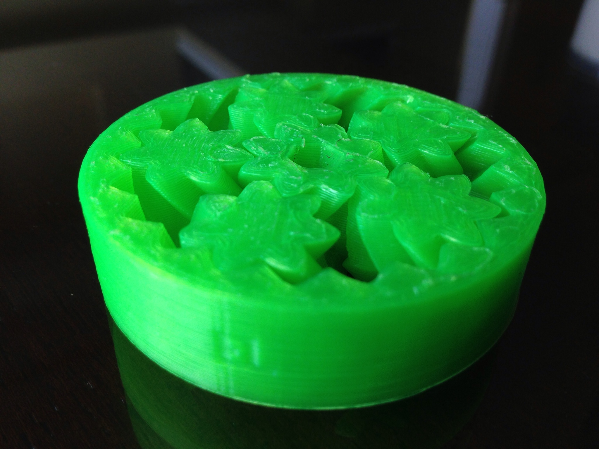

60mm planetary gear with five planets.
60mm planetary gear with five planets. Printed with 0.3mm clearance, it initially felt like a solid block but broke loose easily enough with a hex driver twisting the sun. Ran it with a drill for a few seconds to smooth out the action. Very interesting way to print bearings - it has the axial thrust resistance characteristics of needle bearings, but with no need to assemble bearings inside a race.
