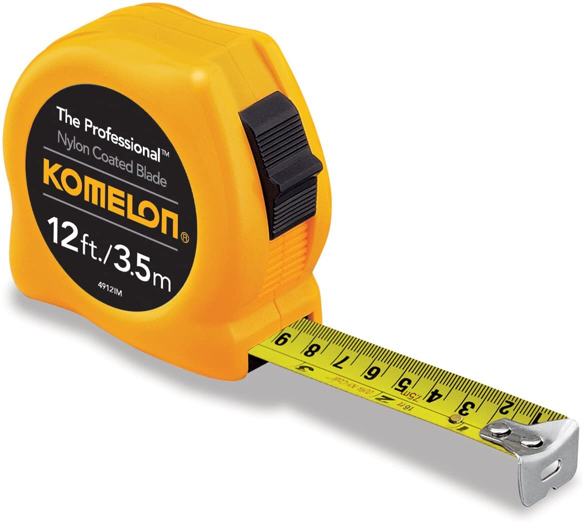

A powered tape ruler is fixed at one side of the work surface. The ruler is stepper-driven. The controller feeds out the ruler on the surface the full length of the target. The ruler retracts a distance that is equal to each increment whereas the operator makes a mark at the end of the tape.

you could connect a gear upto the center of the tape measure, put an encoder on it and then a batter powered LED with light-piped pointer mounted on the end of the tape measure. Would have to calc decreasing radius as the tape measure was pulled out but the LED could be controlled to light at specific intervals. Wireless control of the LED would be an upgrade option.
