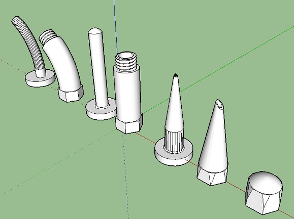

A 3D printed caulking gun kit Includes:
Includes:
  • End-cap for sealing the tube after use.
    Note: Use a piece of folded plastic bag under the end-cap to ensure the seal is airtight
  • Extrusion tip
  • Straight extender
  • Curved extender
  • No Waste! Push-through cleaners to ensure that no caulk / silicone is left over at the end of the job. The next day any remaining residue in the tubes can easily be removed.
The STL files are posted on http://youmagine.com:
The sketchup file is included in case anyone wants to change the original design files.
I hope someone else finds this kit as useful as I have!

A request:
Could somebody from North America please grab their calipers and measure the diameter of the standard caulking nozzle sold over there?
I would like to add a little piece to this kit that can be glued onto the smooth nozzle and present a screw thread that allows this kit to be useful for those caulking tubes as well.
Many thanks in anticipation.
Its cone shaped like the Aussie one, 15.38mm is the max, and 71mm is the length.
@Jeff_Dewe Thanks mate, I’ll have a hack at it tomorrow and upload the result youmagine.
