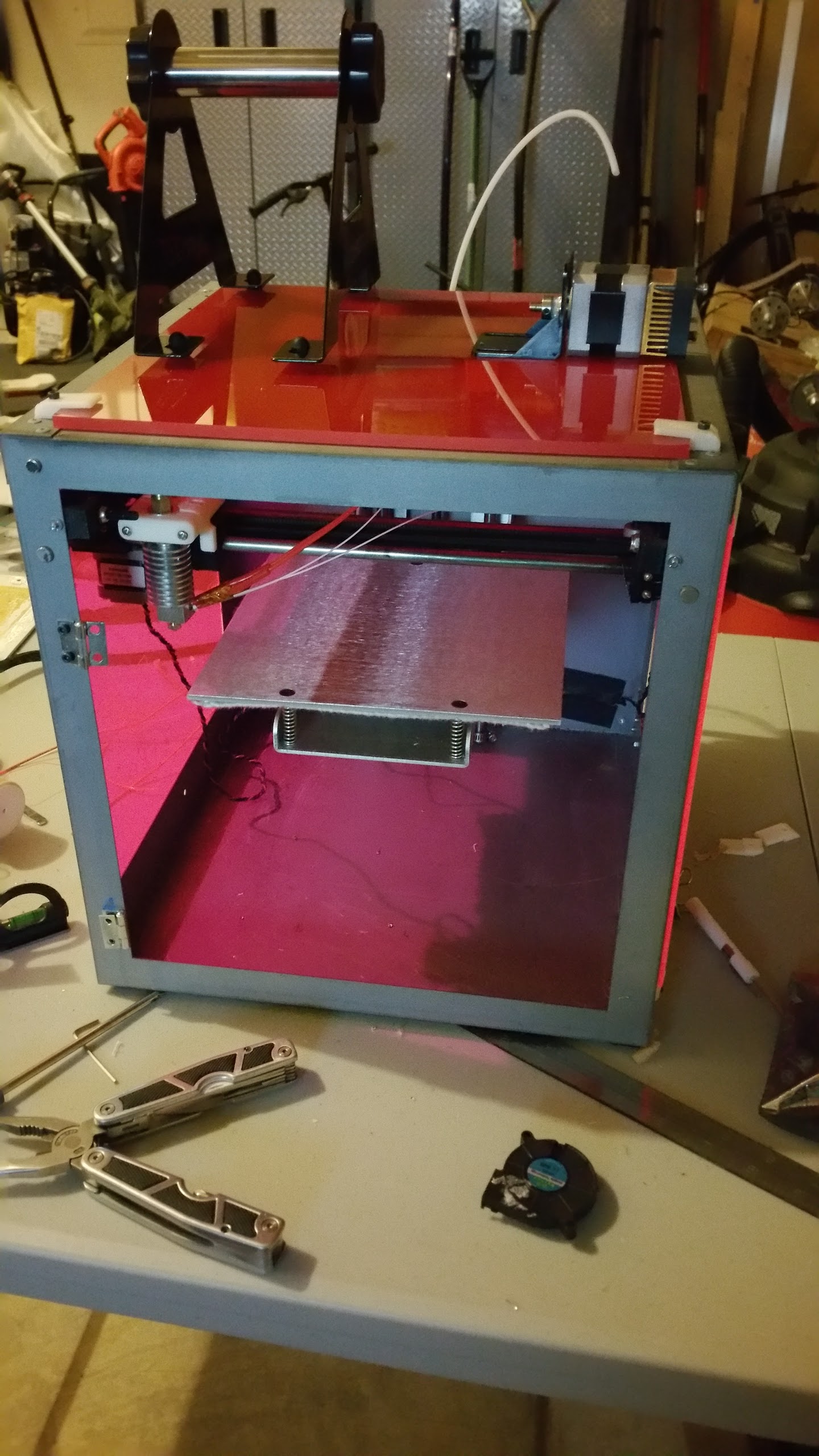

A bit behind but still making progress on the Solidoodle SD3 conversion. The bed is on and leveled the old fashioned way…with a level. The top panel is on (new clips for that) and the extruder placement has been tested. Tomorrow, hopefully, I can install the extruder motor and if the polycarbonate door arrives I can install that. If not then the conputer I built out of a stick PC and a converted mini-note LCD, with my wireless keyboard and trackball. Since Ray’s board has no provision for an LCD, I will not bother with it. Originally I was planning to embed that in the door. If Ray’s board is working fine I am unlikely to take it out of service until and if, it actually dies. Nonetheless, this printer will not require a separate PC. @raykholo ​, your thoughts on using OctoPrint or Astrobox would be appreciated as that will allow me to embed the entire arrangement in the LCD case.

Red printer will only print red :wink:
Nice build :slight_smile:
Nice
