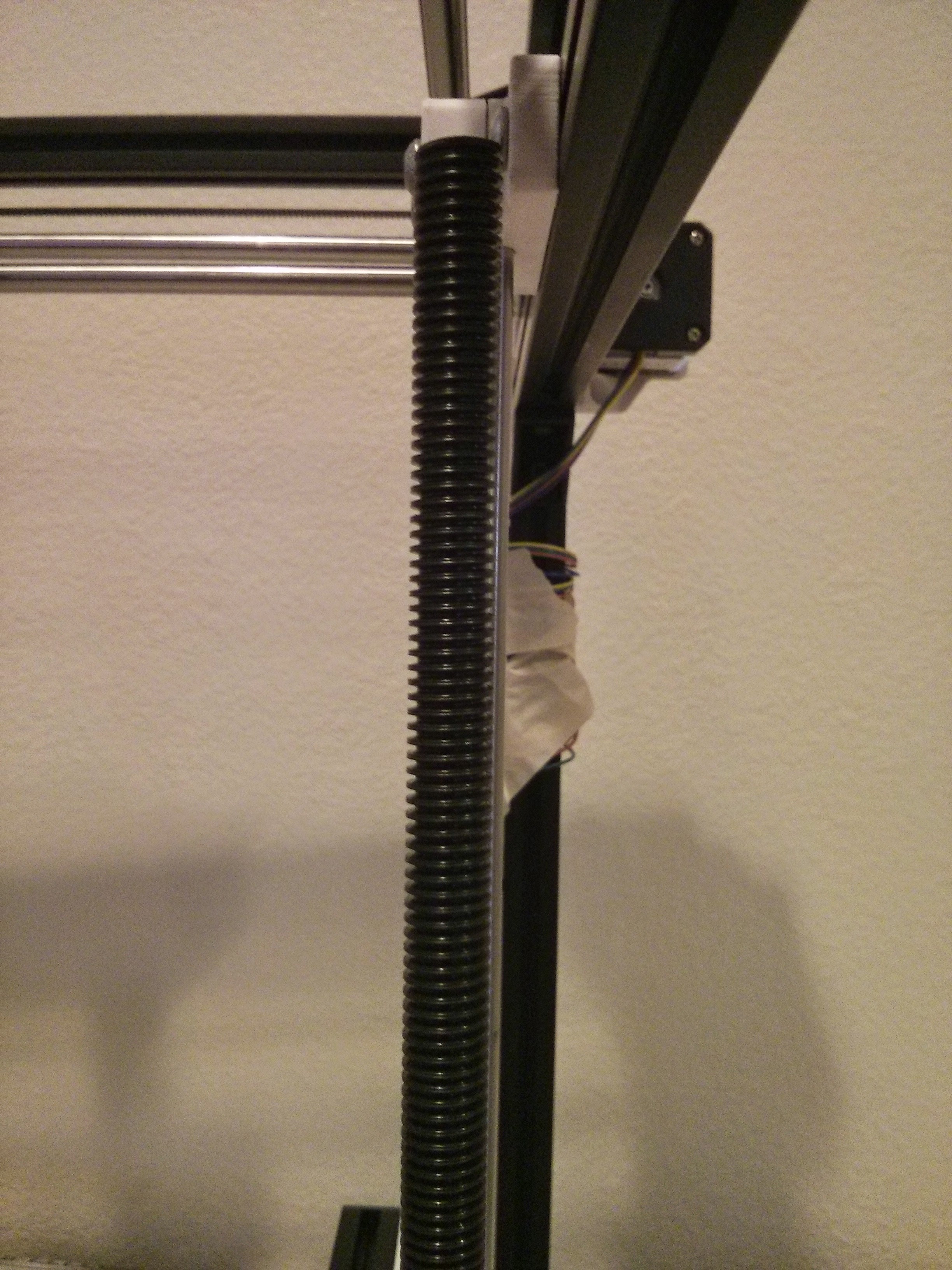

A bunch more photos, sadly no progress.
The smooth rods now fit into the clamps perfectly, no problem there at all.
However…if i place the bottom z mounts in the correct measured positions then I can barely turn the leadscrews at all. I have to loosen one side which pops back a little further and then the screws move fine.
However, I still get binding when trying to drive from the motor so I’m guessing its still too tight.
At this point I’m at a loss, spent the whole day on this today and no progress, pulled it apart and back together again more times than I can count.
Anyone who has built the V2 z-axis got any tips?
Otherwise I think it might be time to give up and see if new plastic parts would help. Anyone up for printing me a set of Z axis parts for the Eustathios V2, including the motor mount in ABS?
