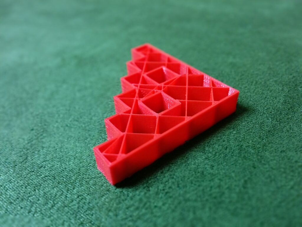

A "calibration cube" of my design.
A “calibration cube” of my design. Sliced with Slic3r 1.2.6 (experimental), each step measures 0.2mm larger than the 10mm increments of each step. I know it’s not my printer because Cura g-code produces much better dimensional accuracy. Might checkout a stable branch of Slic3r or switch to Cura.
I’ve been having difficulty getting good fits with my OpenRC Swift prints. Debugging… I’m happy there’s nothing wrong with the printer. :wink:

Tried Slic3r 1.1.7 (Stable). Getting good dimensional accuracy there.

Printrbot Go Large
ah, that’s just a leathery fabric I used to take a nice picture. I actually printed on a heated aluminum plate with painters tape on top.
Turns out there’s a new feature called XY Compensation that one uses to tune print accuracy. Works great.
