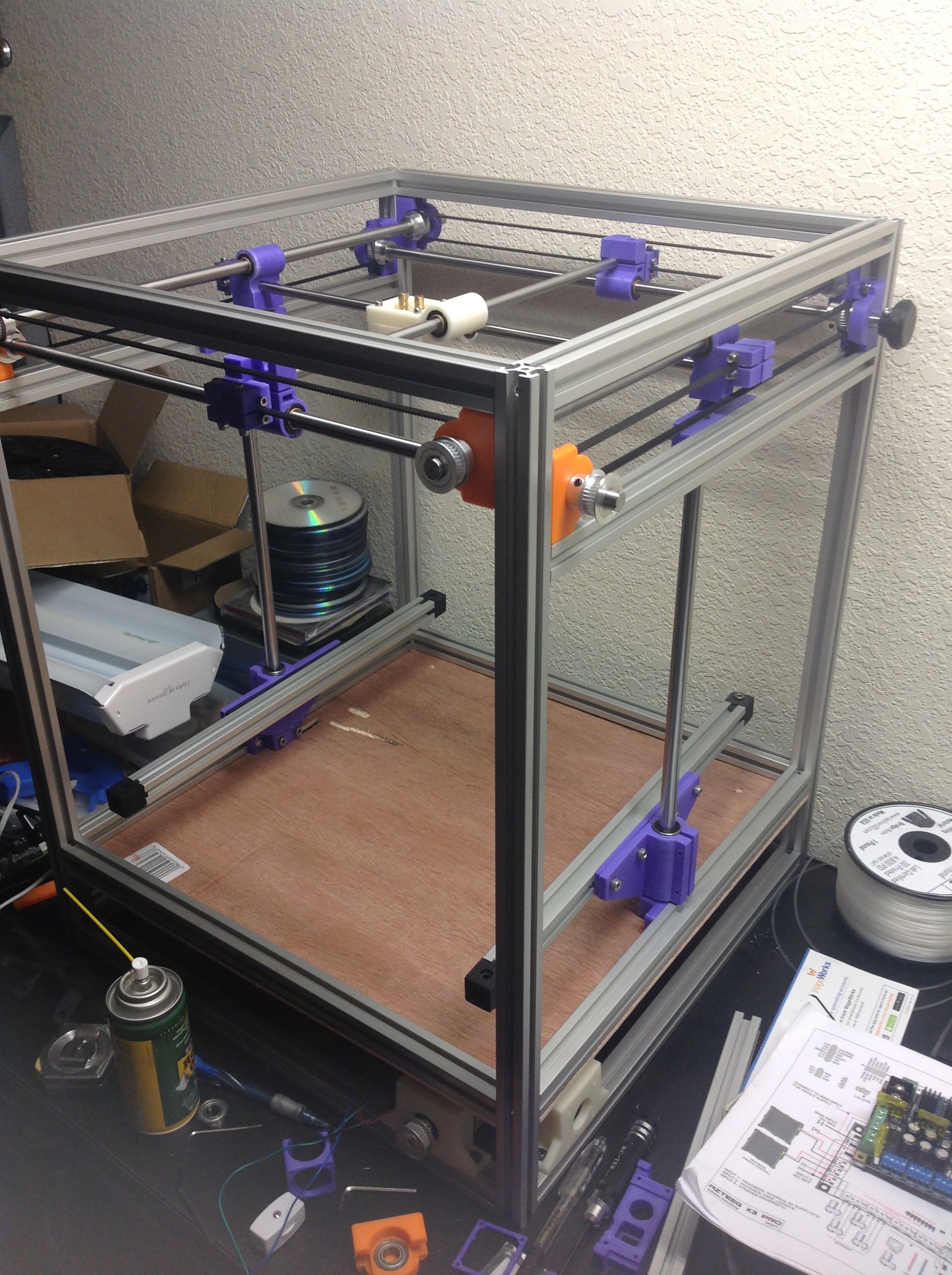

A couple of pics. Mounting the X-Y steppers below in the electronics area will allow open ended belts to be used. Also a pic of the Kraken carriage. Still not happy with it.
So this is something I can use my over-sized can of Rem Oil for
By the looks of it that is a ingentis with belts for the x/y. Is that correct?
@Ethan_Hall I started out building an Ingentis and switched over to the belt drive. I am sure it will change even more by the time it starts printing.
Honestly, those belt-drive ends could be much better too. Someone just slapped large rectangular cubes onto the ends and called it a day. I feel like we could get a better rod clamping system and belt attachment if someone had the time to work on them.
@Tim_Rastall posted some he drew up, but I haven’t had time to look at them yet.
Did you post the files for these anywhere?
