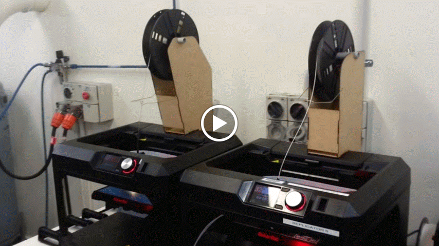

A couple of prototypes of a quick fix for our Makerbot Fifth Gens.
A couple of prototypes of a quick fix for our Makerbot Fifth Gens. The new spool holder design appears to deliver better prints and less extruder jams.

@Nathan_Walkner yep the “smart” extruder is definitely the real culprit, have had to completely strip and run a drill through them to fix the clogs. I run an E3D at home and the difference is remarkable.
I’m hoping the fix isn’t a red herring and I know they will jam again, but the original spool placement does cause a large amount of friction on the filament so I’m hopeful it makes some improvement. Only time will tell.

It’s Windows8 that works but just sucks. ME was a train wreck but at the time we had windows2000 to see us through. As for the extruder on the MB on my printers the difference between a barrel that’s solid metal and one that has a ptfe liner is day and night. The solid metal ones clog like @Nathan_Walkner said. I managed to source a meter of 2mm id 3mm od ptfe tube and put that inside my barrels now
I did drill my own ones till I found a supplier for them. Its even harder than it sounds. Used m5 threaded rod would drill it and had a 1in5 success rate also only had 4mm od ptfe so that left a 0.5mm tollerance till cutting into the thread. Dont miss having to do that.
