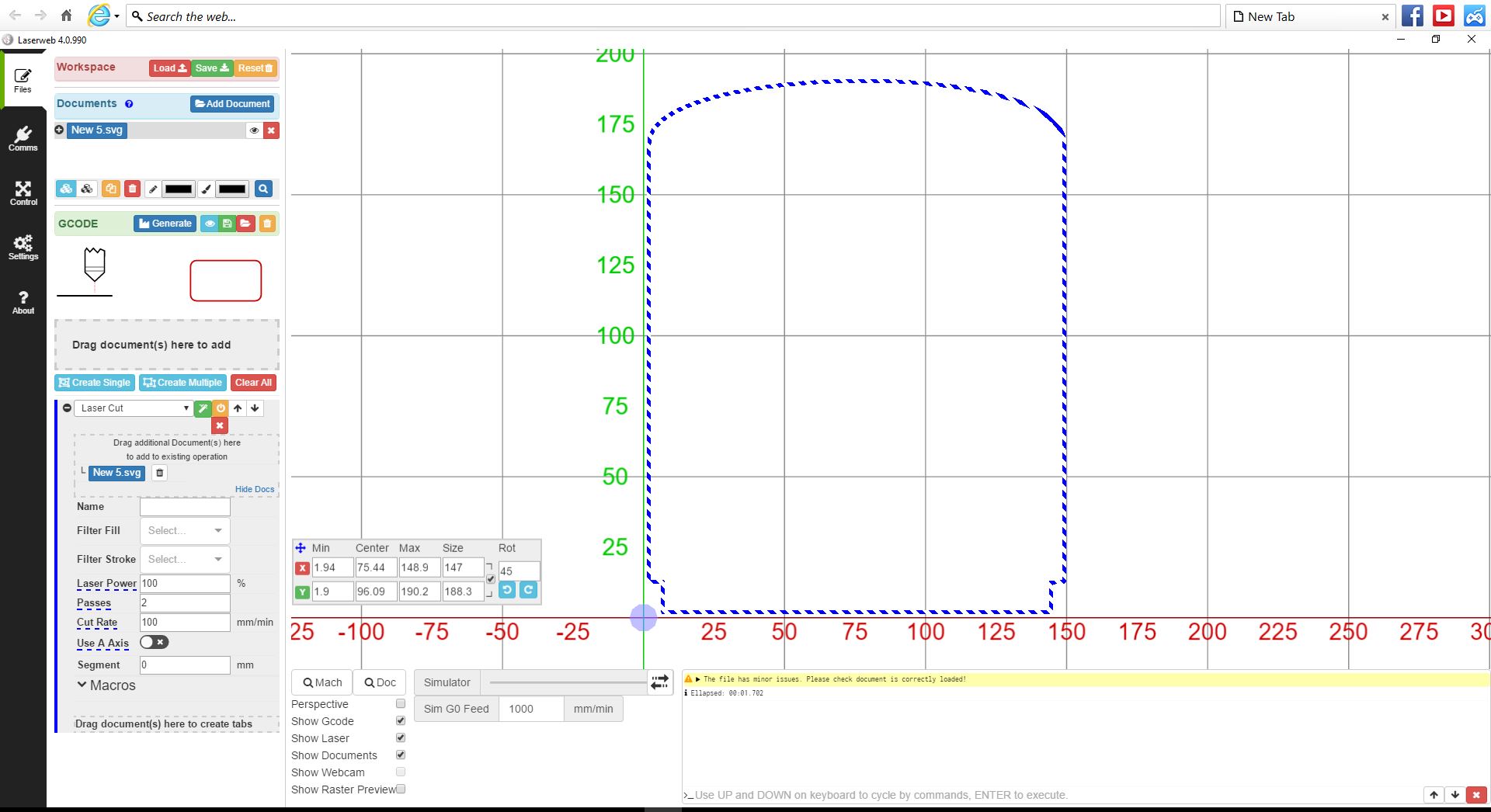

Second question. When I bring an SVG file from Inkscape I always have to adjust the size in LW4. I’m not able to cut exactly the size I built in Inkscape.

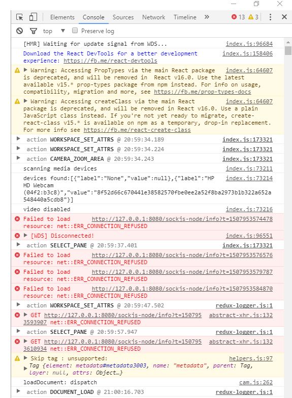

Please open chrome dev tools (F12 or ctrl+shift+i) and paste us the console errors on github.
Only chrome is the official browser for LW. Any other browsers are not tested, sorry.
I’m not sure I understand. I thought LW4 was a stand alone app. How do I run LW4 in Chrome?
Sorry, the screenshot you sent made me think you were running on IE, my fault.

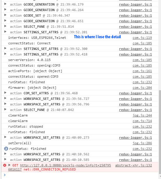

In LW desktop app, on about, you can show the dev tools to report the errors instead.
Thanks @bbowley2 , that is, but there’s not abnormal behaviour logged. Please raise an issue on github to proper debug. Thanks!
