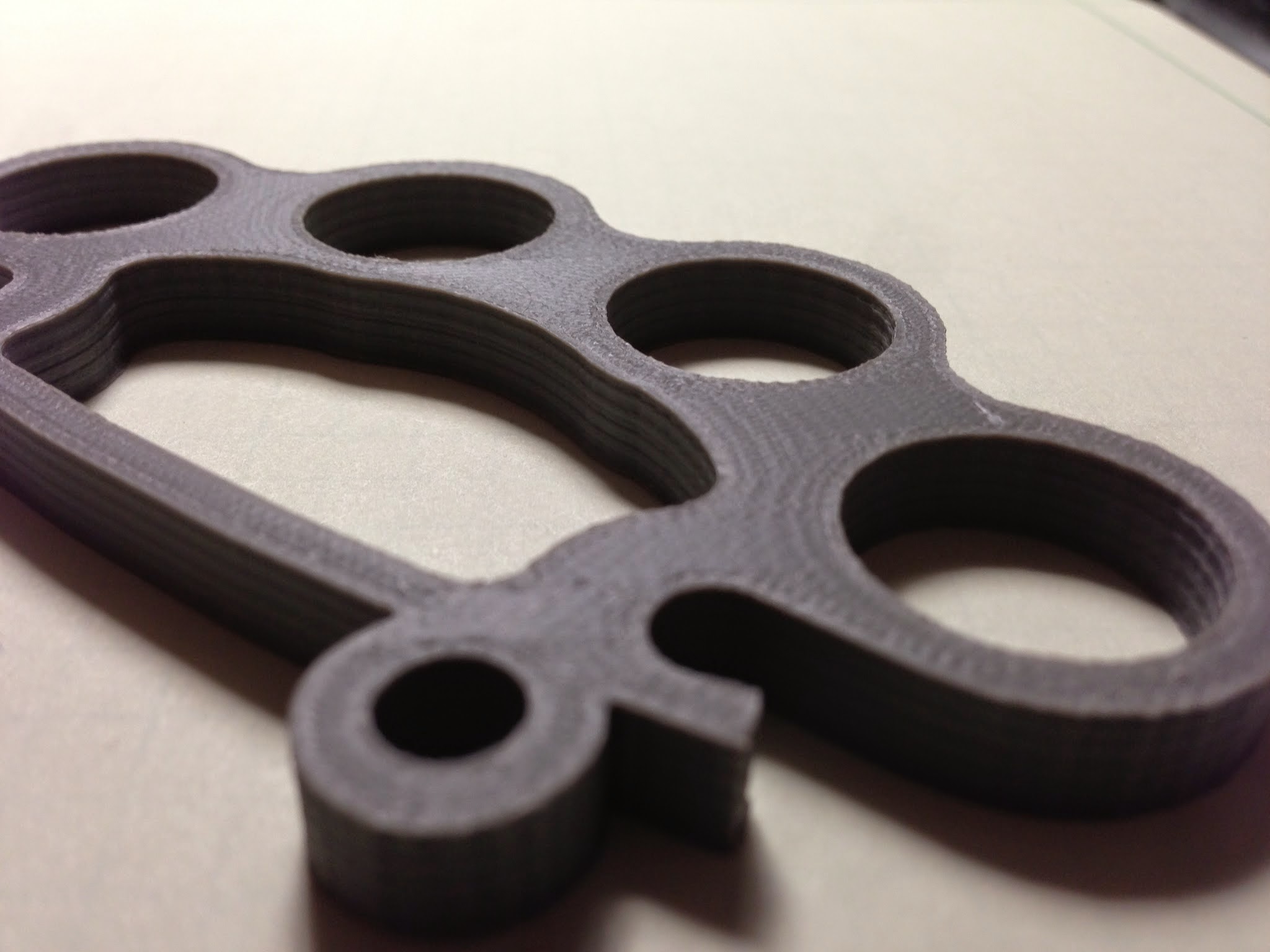

A customer commissioned me to print some models.
A customer commissioned me to print some models. Slic3r was having problems with the thin sections of this model. I ended up setting up Kisslicer for real and after about an hour of tweaking settings, I produced my best quality print yet! I have really liked Slic3r since I started using it but now I wish I had taken the time with Kisslicer sooner.
I should add that my printer isn’t anything terribly fancy. It’s an old Mendel-Parts Orca V0.2 that I converted to linear bearings and T2.5 belts.

“I should add that my printer isn’t anything terribly fancy.” what are you saying the quality looks great

Brass knuckles?
I don’t see much difference from those photos.
They aren’t a comparison. Just different lighting. I always struggled with infill and quality on small areas when I was using slic3r.
@Phil_Hord ABS knuckles :slight_smile:
@zephyrin_JG Thank you. What I mean is that structurally the frame isn’t the stiffest in the world. Granted it’s better than many. I was kind of in a rut where I had accepted that areas of small infill such as around the finger holes were not going to work properly, when I was using Slc3r. I always thought it was a limitation of both the software and structure. But Kisslicer changed my opinion.
