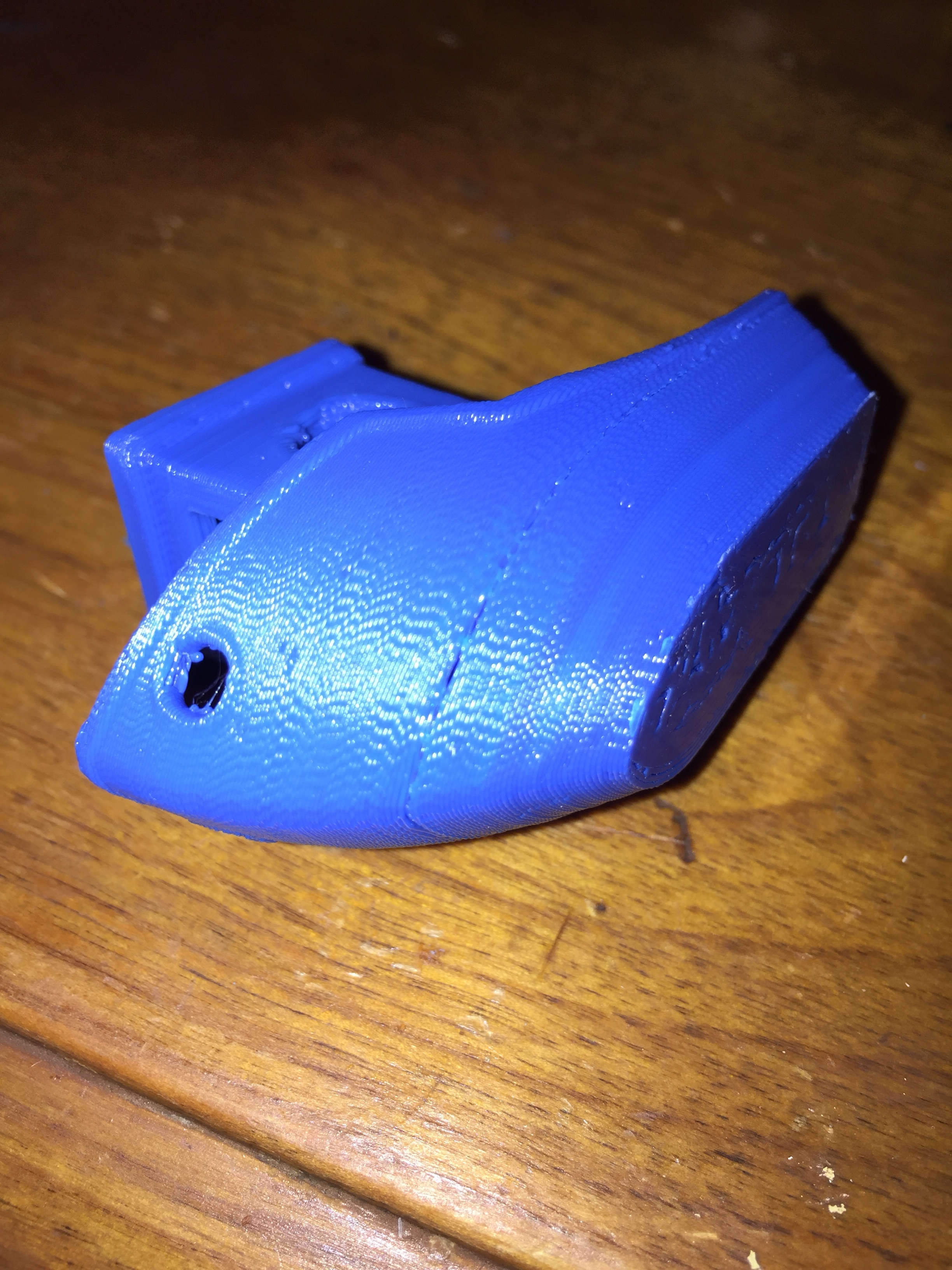

@jerryflyguy to support you further, it looks like extrusion stopped somwhere like 10mm from the bottom. Anything happende there? Further I notice some kind of moiree like pattern on the outside. At what speed are you printing? Changing speed might solve this.
@Roland_Barenbrug yes, I determined that the roll feeding was an issue. I’ve printed a new filament roll mount and that issue seems to have been solved. This part (pictured here) was printed at 80mm/s . I’ve posted a video of a more recent print at 60mm/s which has a different surface texture.
