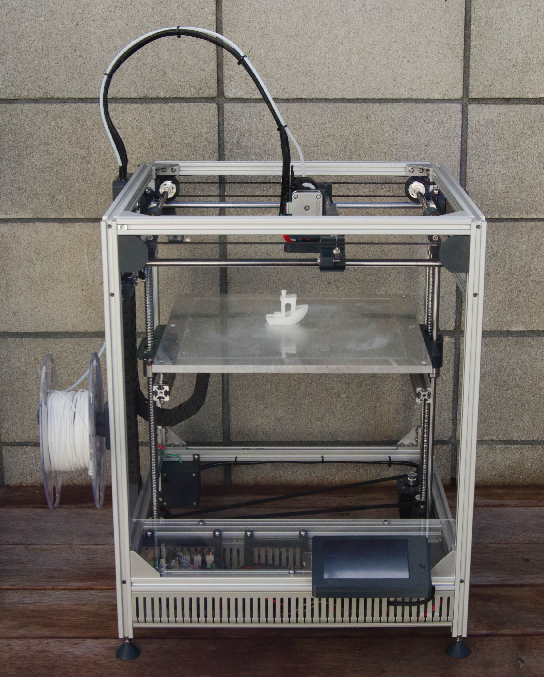

A few photos of my build. I’m calling it finished but I already have a few mods in mind. Since my last post i have got the bed working - 10mm cast aluminium with 3 point levelling and it is working really well. It’s bulletproof flat although it takes quite a while to cool down after a print so might look for a removable build surface. Initially the bed moved a bit. The cause was play in the LM10LUU linear bearings which I got from Robotdigg. I got the rods from Misumi so I ordered new bearings from them and they are perfect - just tolerance differences.
Duet wifi is fantastic. The interface is great and the printer is quiet apart from the blower/fan so might look to modify cooling to dual noctua fans or some other mod - ideas welcome!
Have also fitted Gates GT3 2m belts to X/Y.
Benchy at 0.16 layer height, 45mm/sec. Still workining on optimising speed/retraction/coast settings etc but really happy. Thanks again to all who offered advice along the way.

Beautiful build. Is the pad heater sagging or is that a wire? Might want to put a backing plate behind it to prevent droop which could burn out your heater or worse
@Mike_Kelly_Mike_Make looks like the thermistor wires going to the center of the pad going over the top of the heated section.
@Mike_Kelly_Mike_Make Thanks Mike. Yes Eric is correct it’s the built in thermistor on the Keenovo heater. I’ve noticed that people don’t have a great deal of faith in built in thermistors in general and make allowances for adding another one (custom hole in the heater pad to allow access to the middle of the bed). I don’t have that but if I have to add one later on I’ll put it at the edge. Cheers
