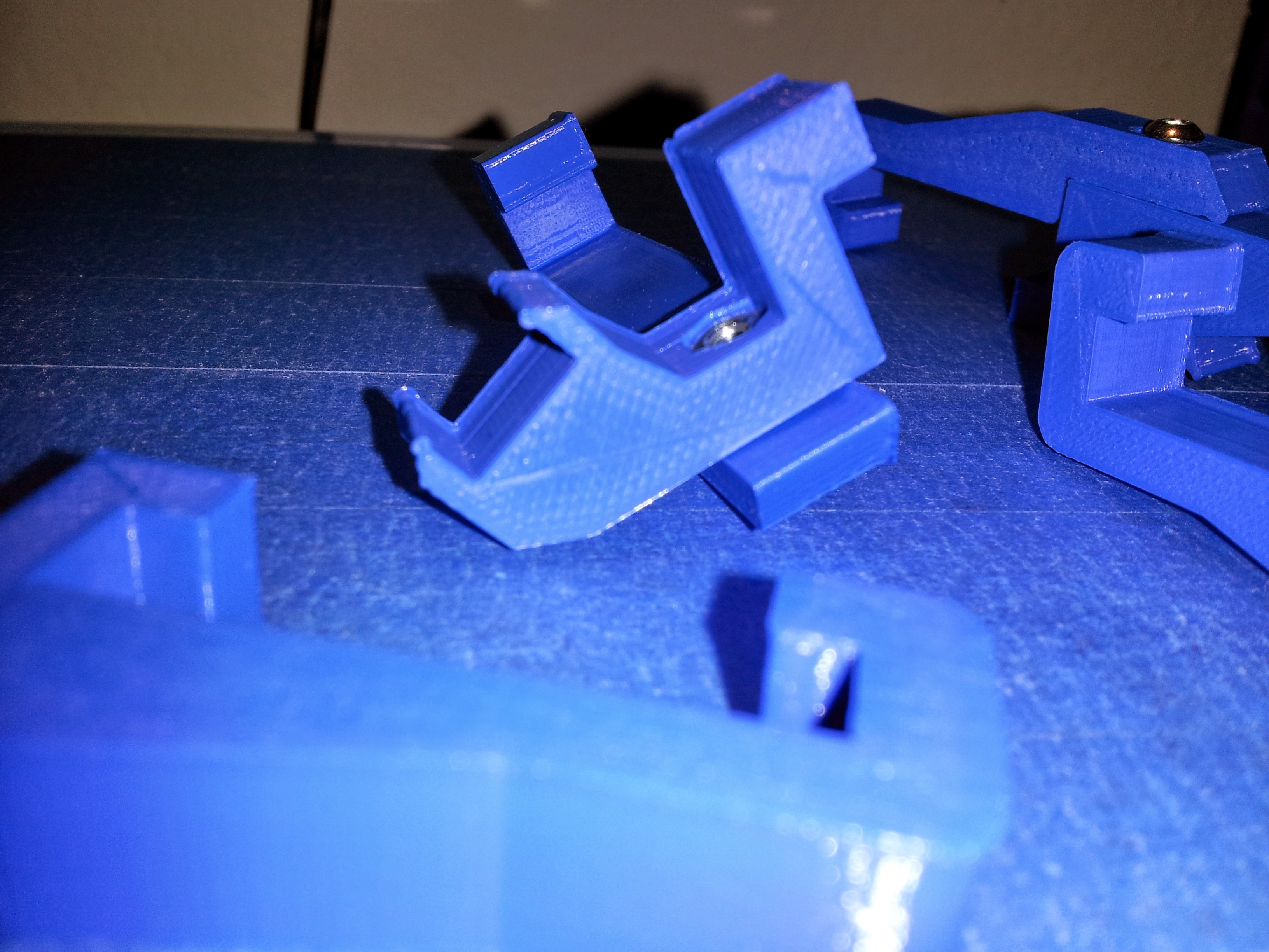

A few pics and vid of my LED bar locking clips.
A few pics and vid of my LED bar locking clips. They work on both side and front openings tilting the bar at the build platform just under the axis slide blocks. When locked they are very sturdy but at the same time don’t require any modification to your #Ultimaker frame. They are easy to remove/relocate as well. I did find that on the left side due to the slide block end stop trigger finger you need to mount them over the endstop screws so they don’t impede sensor functionality (clip has enough tolerance to include the screw heads). You can slide the bars in or simply pop them in as the fingers have a rolled ball tip to help with tension. I will add them to Thingiverse if anyone is interested.

Is the for the IKEA led strip? Looks great. Please add it to Thingiverse.
Yep, IKEA Dioder bars, 4 to a kit.
