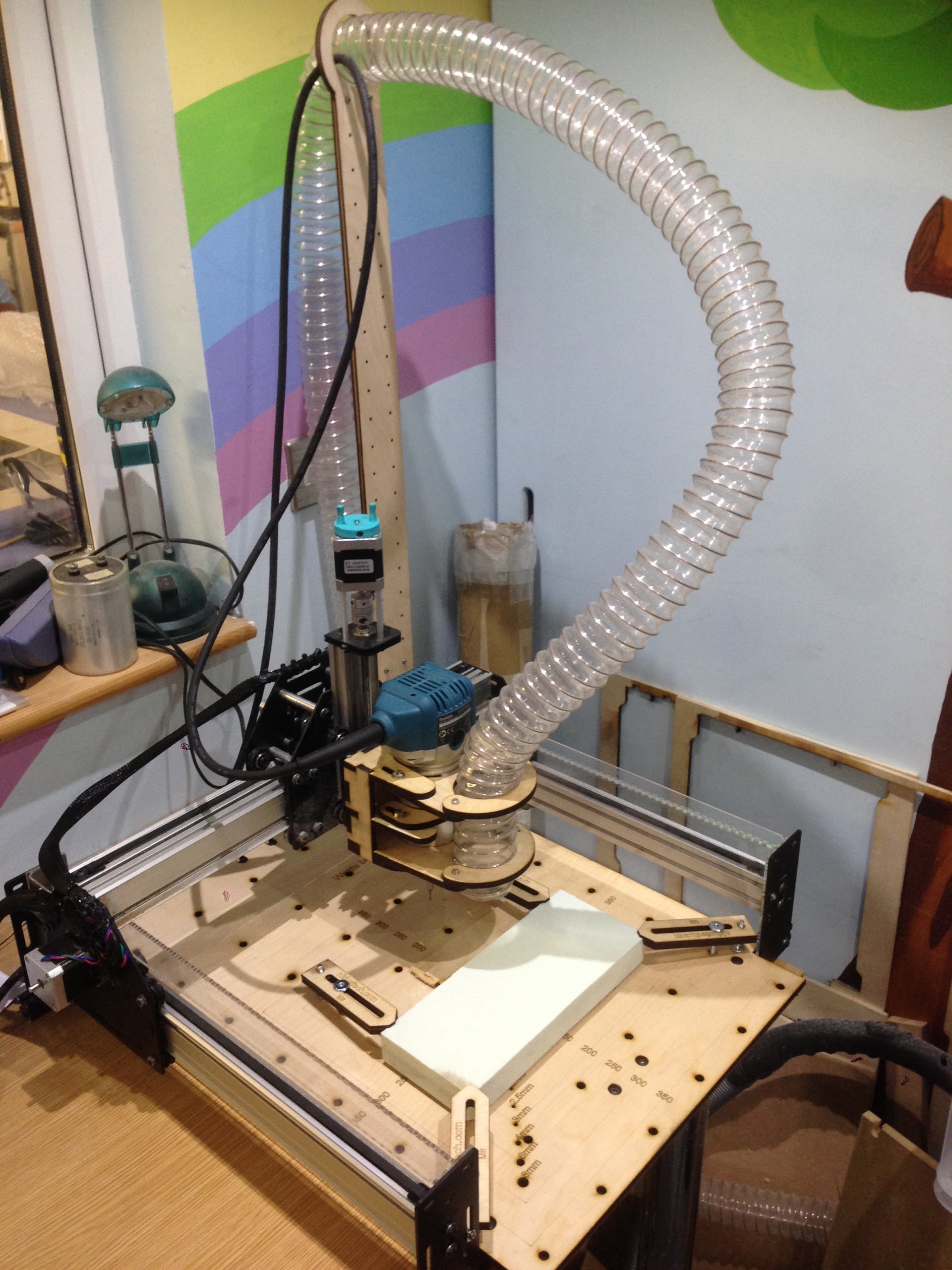

A few wee upgrades to the CNC Shapeoko 2
- z axis knob
- Fan for the stepper drivers. Still need a box!
- Clear perspex rail covers. To stop all the debris getting under the rollers and causing gitters ruining the work.
- A newly designed and laser cut waste board with integrated M6 nuts.
- Same with the hold down clamps.
- The Dremel died and went through a piece of work!! So I could not use the CNC to make mounts for the Makita 700c so laser time! Pulled an all nighter to design and build a ‘Tactical’ mount to get things going. But need to get the Z axis upgrade (or build it
and make some metal mounts.
Things to do
A. Z Axis upgrade to NEMA 23 and behind mount. In fact Nema 23’s all round.
B. Box for the electrics
C. Decent fan!
D. Skirt for the vacuum mount.
E. Cable drags.
F. Side gripping work holders.
G. Metal Makita mounts.
Also musing with the idea of upgrading the electrics and driver for an industrial level unit. What would be good to use with V Carve Pro? Any experience with that? I having varied results with the NC outputs from V Carve and then GRBL controller. Anybody found the best software to use with GRBL 0.8c. Also looking to upgrade to GRBL 0.9.
I use Coreldraw 7 to design in. Any ideas or feedback appreciated. It is driving me mad this week with everything being nearly there, but not quite. I have a three tool job that runs for about an hour. Then one of the GRBL commands are not recognised and the tool goes off in a direction with a mind of its own!! Half the time through the work
