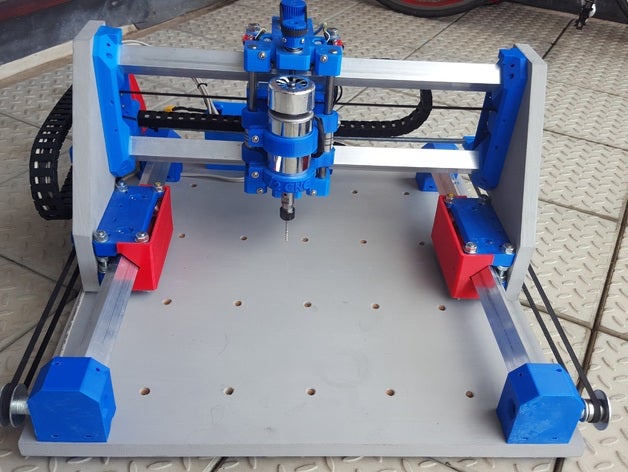

A friend of mine recently contacted me because he wants to get/build a cnc.
He was considering a $200 ebay special till he looked at the working area of the machine.
Together we decided to build a Root 2 mostly printed cnc…
The big question remaining is the control system.
The default is to go with a GRBL stack, Arduino->Grbl_.Steppers.
