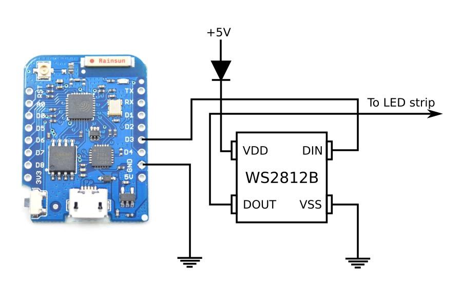

It’s a great hack, I’ve used it a few times. Here’s the diagram I made for it:
https://todbot.com/blog/wp-content/uploads/2017/01/sacrificial-neopixel.png

@Tod_Kurt There is a small bug in your diagram, it connects +5V between the first and second pixel (shorting out the dropping diode) when it should run only to the second pixel
@Garrett_Mace oh crud how embarrassing, you’re right. Here’s the fixed diagram.
